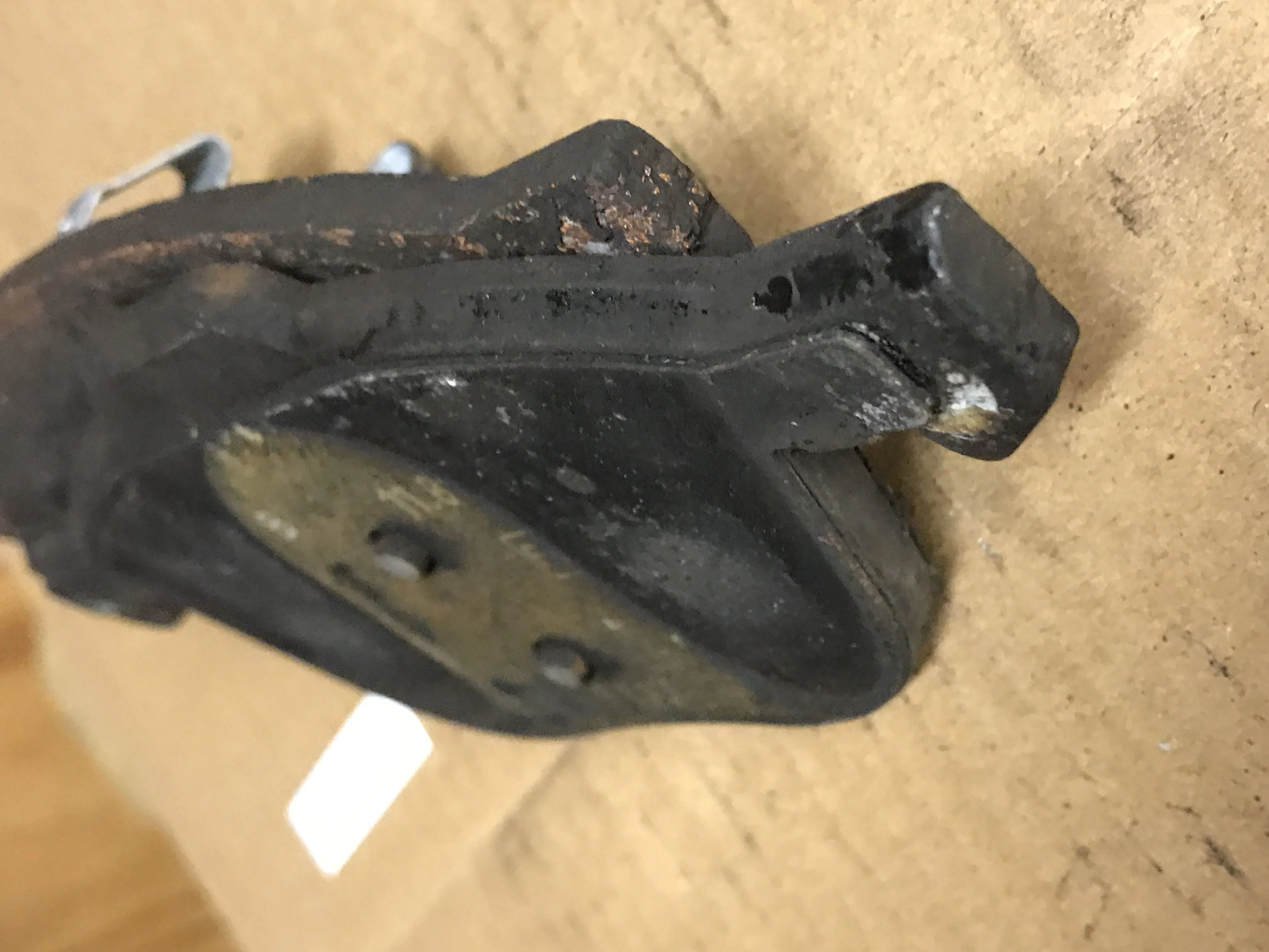

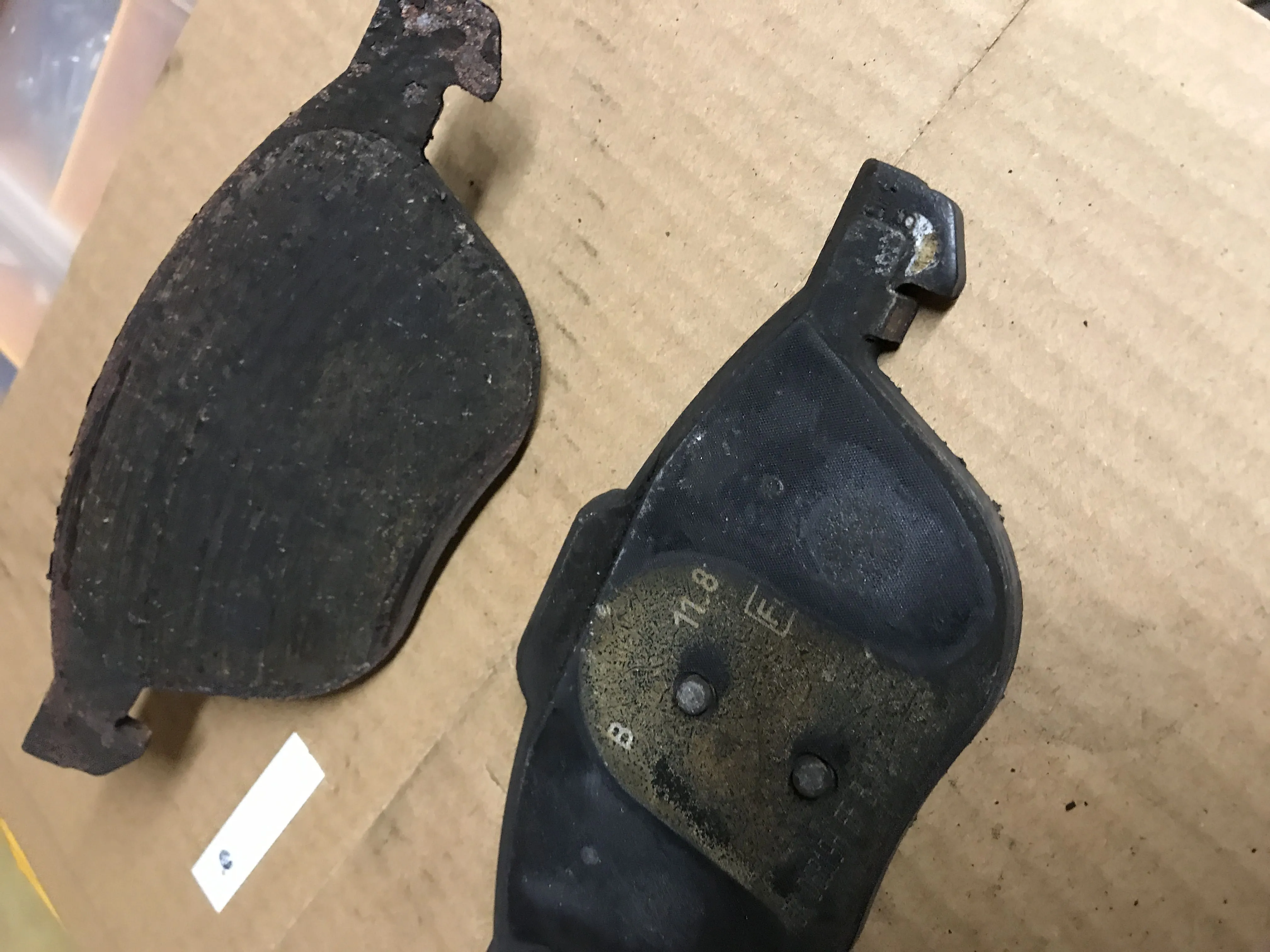

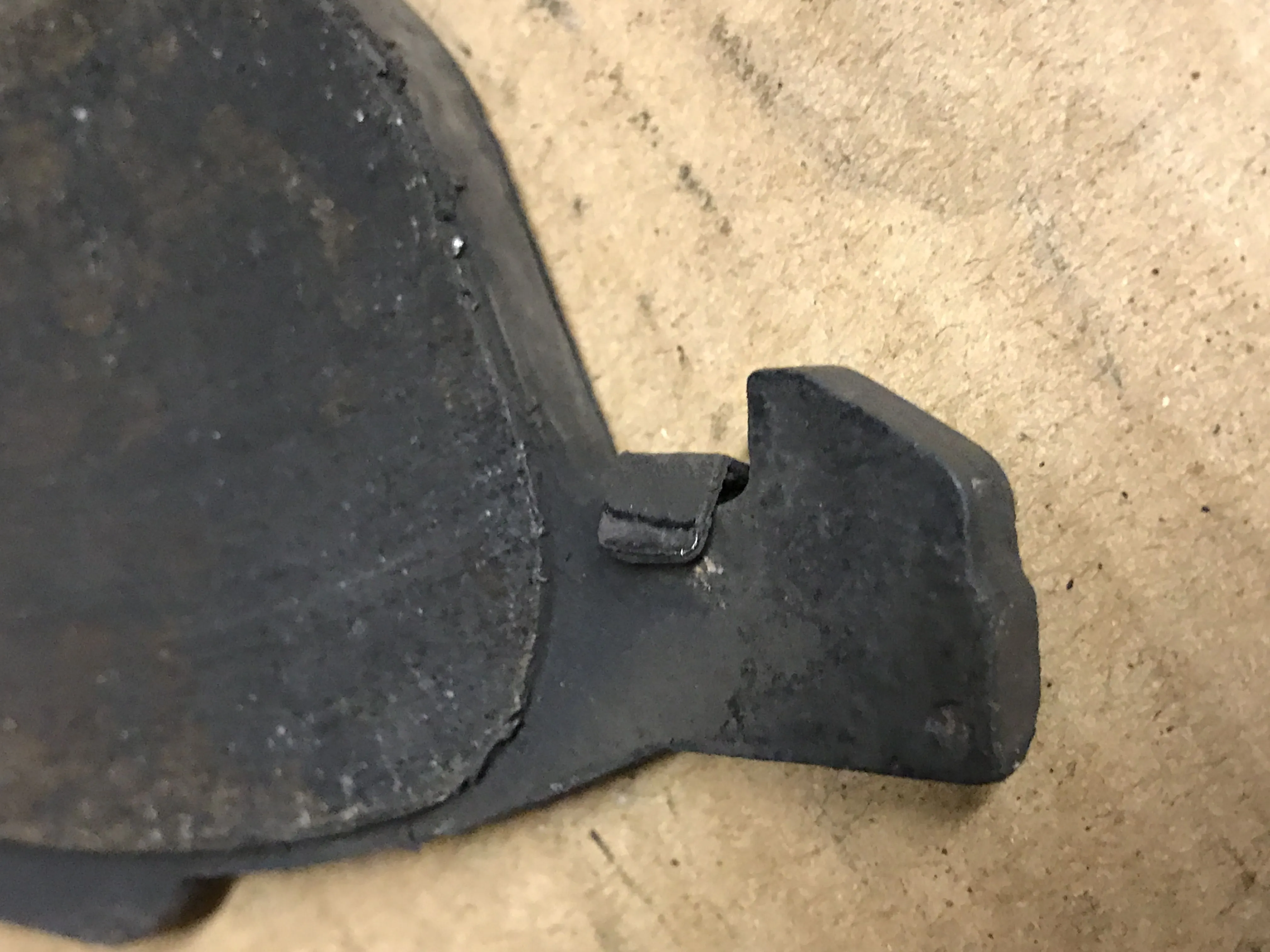

Update. About 500 Miles later. I am still having noise at low speed braking after the pads warm up. I was about to throw away the old pads when I noticed the pad shims on them. They appeared to be glued to the back of the pads. These did not come with the Hawk Pads. Old Brake Pads 2.webpOld Brake Pads 3.webpOld Brake Pads 1.webp I took some pictures.
My new Hawk pads clearly did not come with shims. See Photo's. I have contacted TireRack (Where I bought them) and they confirmed that they are supposed to come with Shims attached.
Finally getting to the bottom of my noise problems.
