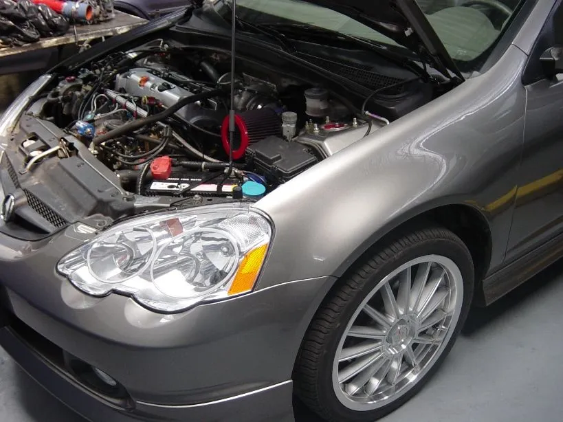

Have to share with you my new toy
I am so excited, that I just have to share with you about my new toy finally running good. It took months to have it running to the level I really wanted.

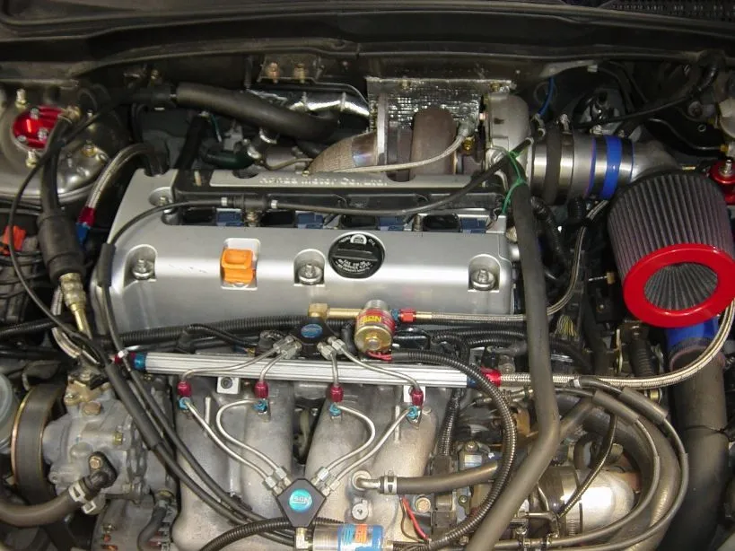

It is an Acura RSX type S which has been turbocharged and it is the hardest engine to tune so far for me, but thanks to the Haltech E6X it running very good.
The car is making 505.4 WHP and 430 lbs of torque and 11.7 sec at the 1/4 mile.
The engine has crower rods, JE 8.5 to 1 CR, Drag Competition Manifold and intercooler, Haltech E6X, 255 Walbro fuel pump, 75 Lbs RC injectors, and some other mods.
I know this is not a Mazda, but I have to share with this comunity that has been very pretty good for us.
Here are some pictures:

holy crap. e6x seems to be doing well.
how many lbs of boost is it running?
-B
-B
Yeah, the E6X is doing a lot better than the Hondata and e-manage. I can control the V TEC as well as many other sophisticated cam timing features in these engines.
It is running 15 psi daily and 22 at the track. The dyno was at 22 and the bumps on the dyno results are the boost limiter I had set at 1.5 Bar. I am putting a larger GT35R as the GT30R is maxed out.

Oh yes Linux thank you. I don't care what they say or think. On that case it is not for business, so they are the ones who don't want to take my advise, I just want to share with them all I had to go thru to have it run good. All the fuel system has to be upgraded. The fuel pump, fuel lines, make new return line, install a regulator, larger injectors, Haltech E6X plus the regular stuff on a turbo engine. Plus those engines are 11:1 compression. You can imagine how much time and money it takes to get it right.
