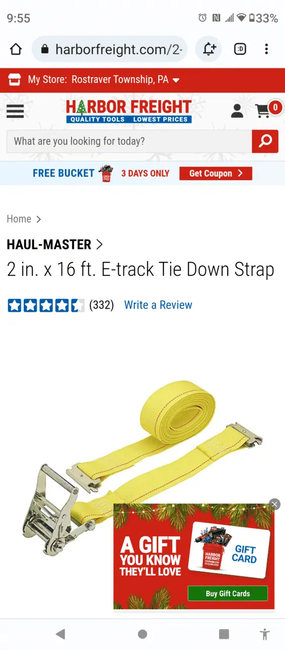

Pop out the plastic recess handle from the lift gate. Get yourself a flat ratchet strap like below and thread it through/around the metal frame where you took off the recess handle. That takes care of closing it.

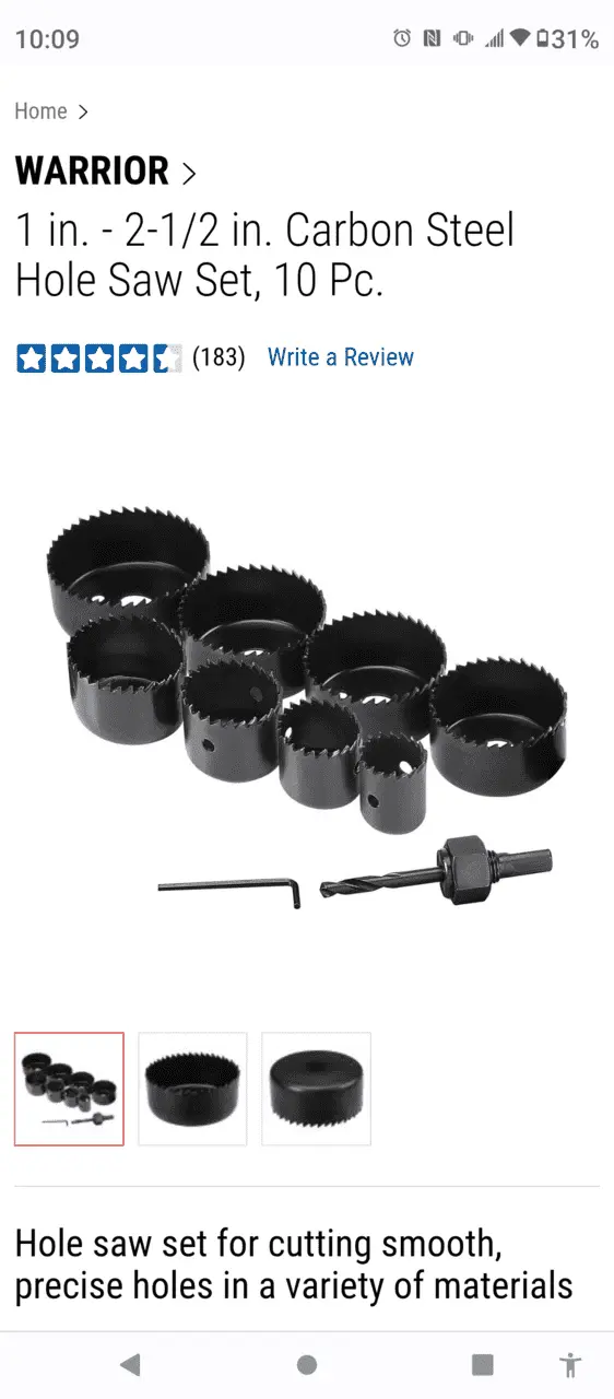

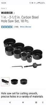

To open, you gonna have to figure out where the latch mechanism is located.... You will need to precisely locate a place to drill hole(large enough to fit a strip of metal using hole saw bits) in back panel of liftgate...see if you could fashion a piece of strip metal that can be used as a lever to turn/unlatch the lift gate. Once you have a way to unlatch then you will have to push the lift gate open using manpower.

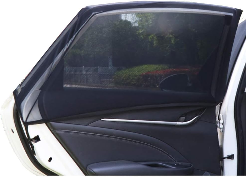

I also have a netting for the windows which allow you to open the windows for better airflow and keep bugs out.
