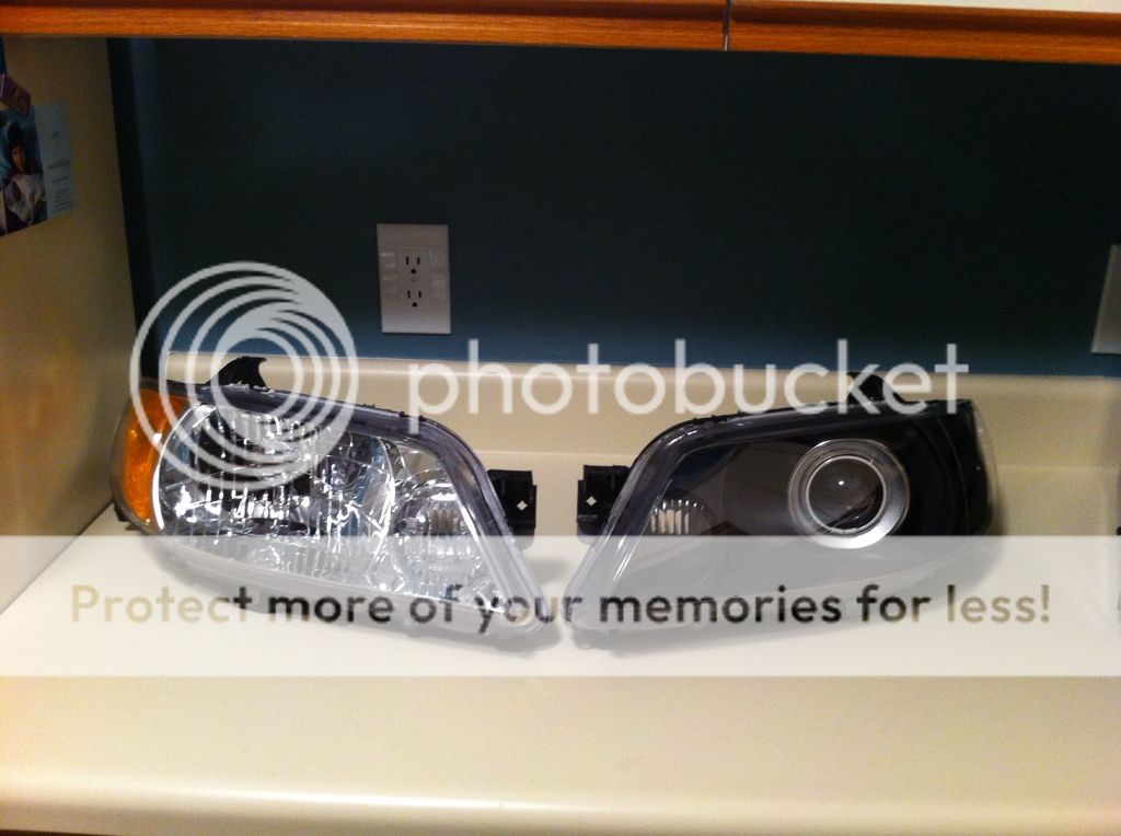

These are the same lights but those on the left i painted and retrofitted (Yeah, i know they're protege lights but it's just for ref)
