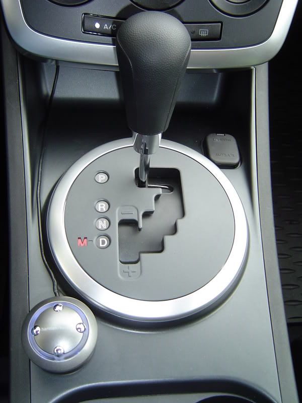

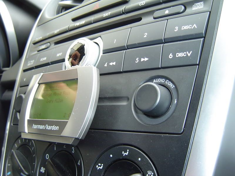

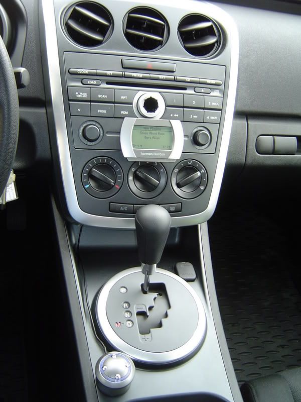

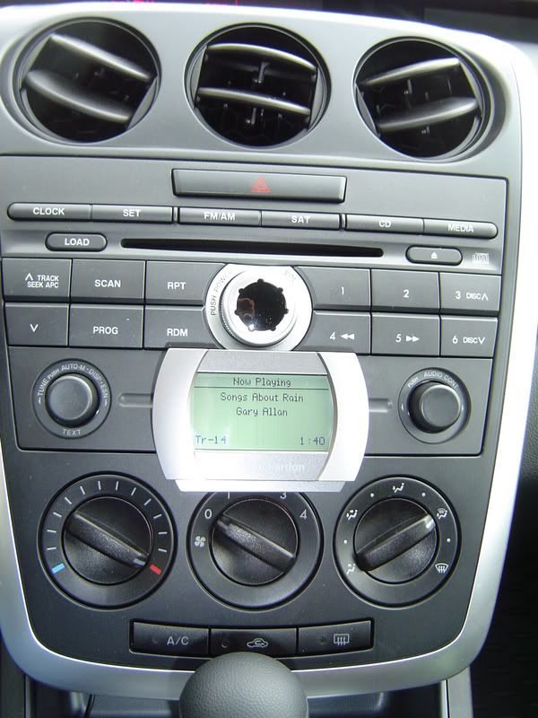

Just finished the install of a Harman Kardon Ipod Link in my CX-Z. I have the stock radio so I used an FM Antenna Cable that goes between the deck and the FM antenna. I would reather use a direct input, but this sounds really good. If I can figure out how to get RCA inputs on the stock deck, I then could use those as the Harman Kardon has RCA outs as well. I haven't drilled a hole to hind the controller cable yet, I want to make sure I have it where I can use it the best first. I really like this unit as it displays the song titles and artist just like the ipod. The ipod is hidden the arm rest. The controller works like the ipod as well to manuver through the menus. Here are some pictures of the install
