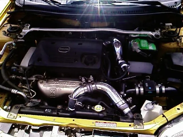

if anyone wants i can take a vid and a pic(dirty engine i am on a dirt road) and then post them up. lemme know.

please post the vid/pic i want to see what these harpipes look like, just curious

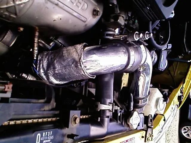

the problem with the pipes aren't just the couplers, it's the bends... they have sharp bends near the outlets making couplers hard to fit and seal right

il take a video for the BOV and spool. and il take a pic of the dirty ass engine bay with shiny pipes haha. when you open it you eyes go str8 at the pipes and then u look at the dirt like what kinda person drives this thing(omg)
