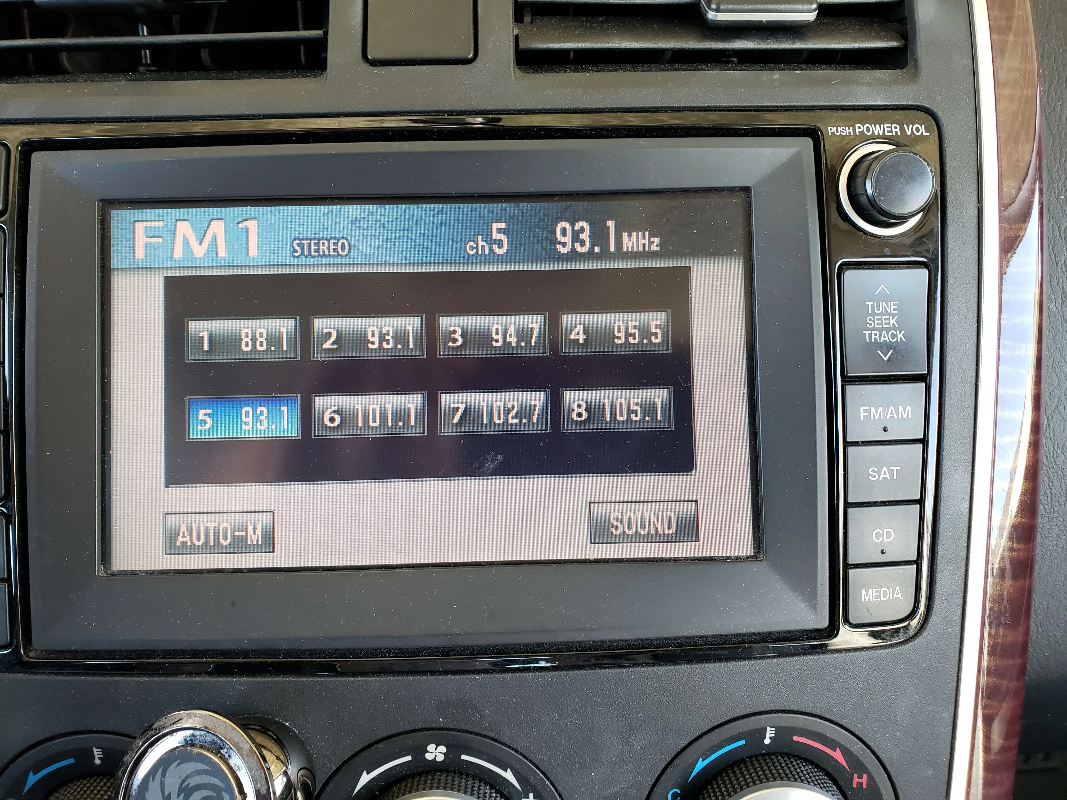

I have a 2008 Mazda CX-9 with a navigation touch screen. The radio buttons are electronic and are integrated into the touch screen. They are not analog buttons as have been shown/described in this thread about resetting the hands-free security code. I have tried pressing the radio power button and the 'seek down' button along with pressing '5' on the navigation screen. I also have followed up these steps with pressing the 'Auto-M' button and then number '2', both of which are on the Nav screen. This has not reset the security code. Does anyone know the steps to clear the code with an electronic navigation screen?
