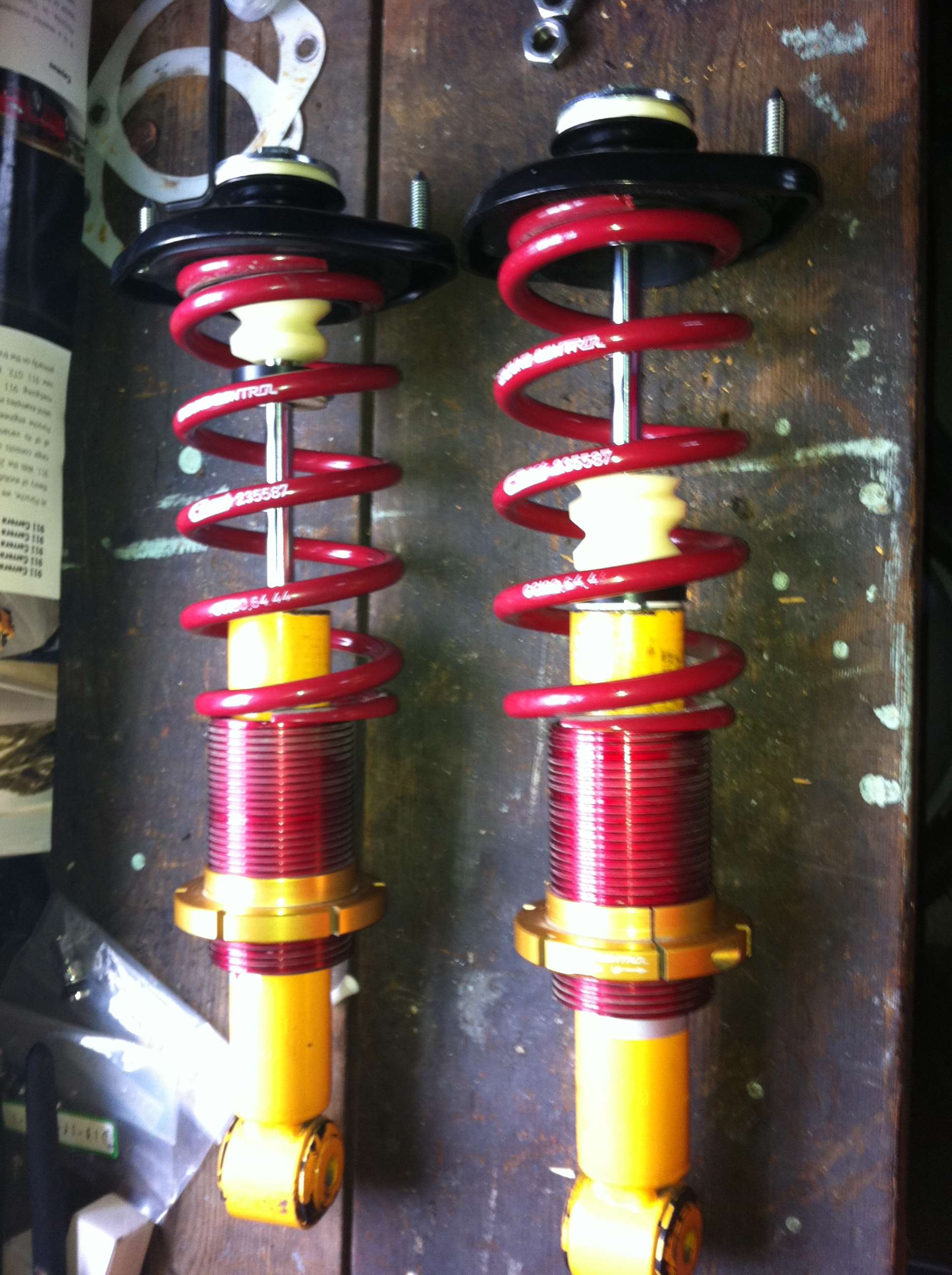

Coilovers are easy to adjust. There are the ones I have on the Miata so the MS3 ones will be a little different looking but it will get the point across...
You can see there is a threaded sleeve all you have to do is move the threaded sleeve up to raise the car up. And you don't have to take them off the car to adjust them. I had these off the car to do something else.

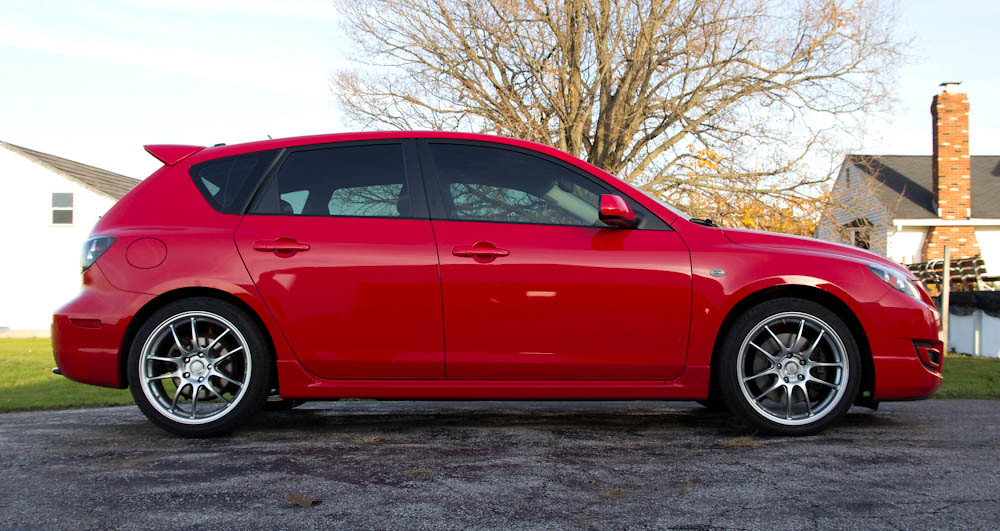

So I'll check it Monday, one of my work friends is bringing a jack to check it out. Here's a pic in the meantime of the height.

Nice looking car!
The MS3 has a multilink rear suspension so it isn't possible to have "coilovers" in the rear of the car. Coilover kits usually have an adjustable perch that sits underneath the spring so that the ride height can be raised or lowered. When you get the car jacked up take off the front wheel and snap a picture of the setup. Any markings you can find on the springs or struts would be helpful in identifying what you have going on as well.
I want to agree with rs on those springs being Cobb. But the Cobb springs are supposed to be a dark blue and those look faded which I guess is possible. In any case, I really like the ride height you have!
Looks like you have COBB springs, they are the only ones that I know of that are blue.
Thanks - you could be right, they do look a bit darker in person, the flash lightened them up a bit.
