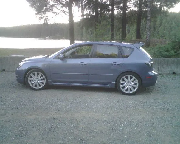

Hey my name is Mike, and i am new to the forums, didn't even think before to check something like this out, have got alot of useful info from reading all the forums. i have a 2007 speed3 and i want to lower it, i like the looks and handling of a fairly low car so i was thinking either the H&R springs with an aftermarket strut or going with the BC Coilovers? i also can't stand the look of a lowered car that looks lower in the back then in the front.what would you recommend? and why? i really need some help on this as i don't want to buy something and wish i had got the other, especially if i'm about to throw down over a grand. what do you guys think about just going with the H&R lowering springs and going with stock struts till i need to buy new ones, or will the ride be to bouincy with out them? thanks alot guys any info will definately help. i am also going to buy some new wheels and tires as well and want to know what rim and tire size goes the best with having a low speed.

I got a set of BC Coilovers you can buy, they are great. Fully adjustible ride height and stiffness, and they change the handling of the car dramatically. 225/40/18 clears the fender better when dropped.
hi Mike, before this is moved my Cobb springs did exactly what you want for looks. And they are designed for the stock struts. 250 or so. Good luck!

They are still set to the settings I had them at, it's about a 1.5" drop. The front sits slightly lower than the rear. If you are comfortable with tools, the install is a piece of cake. New they are like $950 or so. Mine have ~1,500 miles on them, and I have them in my for sale thread for $800 shipped to your door. The only reason I'm selling them is because I'm returning to stock for now, if I had a choice I wouldn't sell them!
