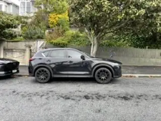

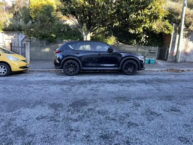

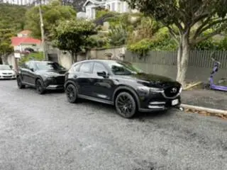

I recently had a shop put H&R lowering springs in my 2018 CX5 - the front rides fine but the back is super firm - like it has barely any suspension at all back there. I have lowered heaps of cars before and I know this doesn’t feel right - the balance front to rear is way off. Any ideas? My car is front wheel drive and is super light for a CX5 - 1550kg I think - (3417lb) I have checked and they are apparently FWD springs not AWD. The installer said there were no bump stops on the rear shocks at all - not sure if that means anything. Do I need to change shocks maybe? It rides a little better with a bit of weight in the back, but it’s still not tolerable. Thanks for your help!

I believe the bump stop is built into the dust boot. I know h&r didn't list the need to cut the bump stop, but MAYBE it was an oversight and you do need to cut it. That would explain why you feel there's no travel at all.
Yes yes yes. The more I think about it, the more I am certain I am riding on the bump stops. H&R said they are only 25% stiffer, so it’s not the springs.
Corksport requires about 1.5 inch or so chopped from the bump stop. Might want to look into that
I got the bump stops trimmed by 50 mm in the end, it’s ok now. I still think it’s firm in the rear but it’s totally driveable now. I don’t know why H&R springs drop it so far in the back - bizarre. I feel that shock travel is compromised, and it looks stupid. At some point I may get custom rear springs to even it out a bit - 30 mm front and rear would’ve been fine.
