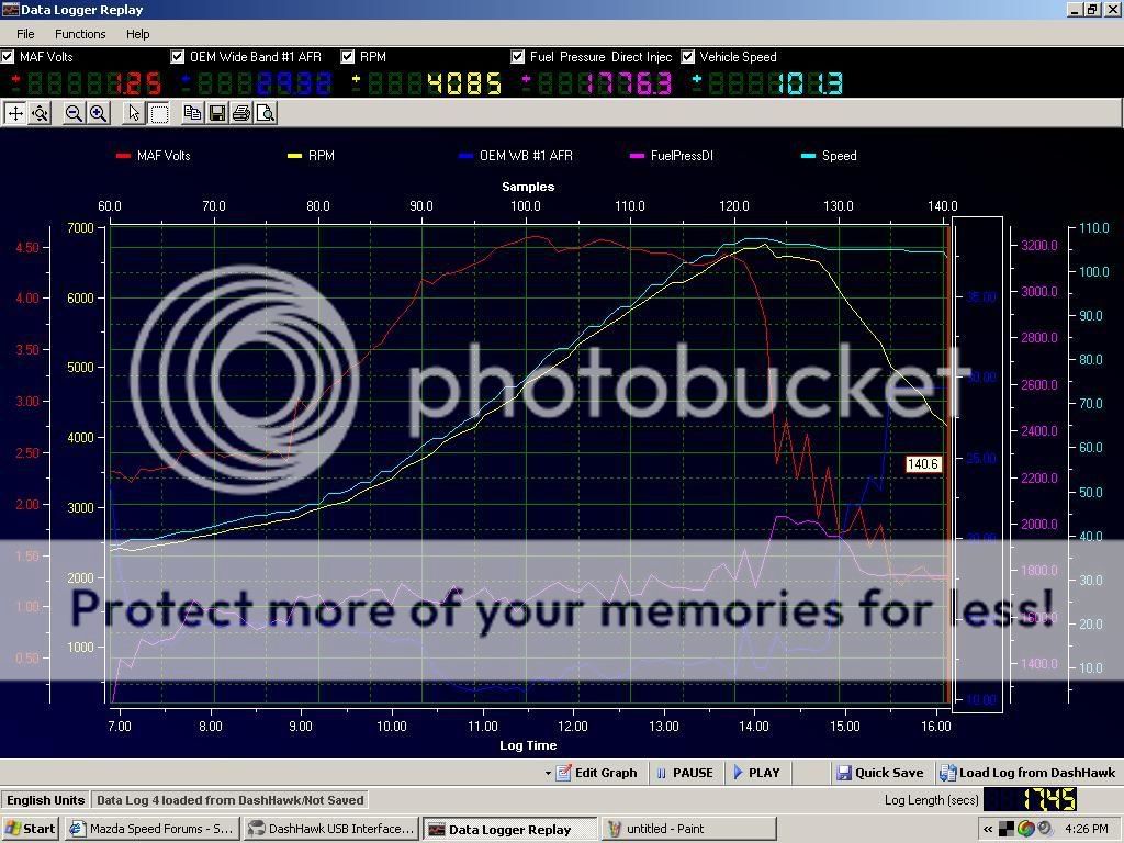

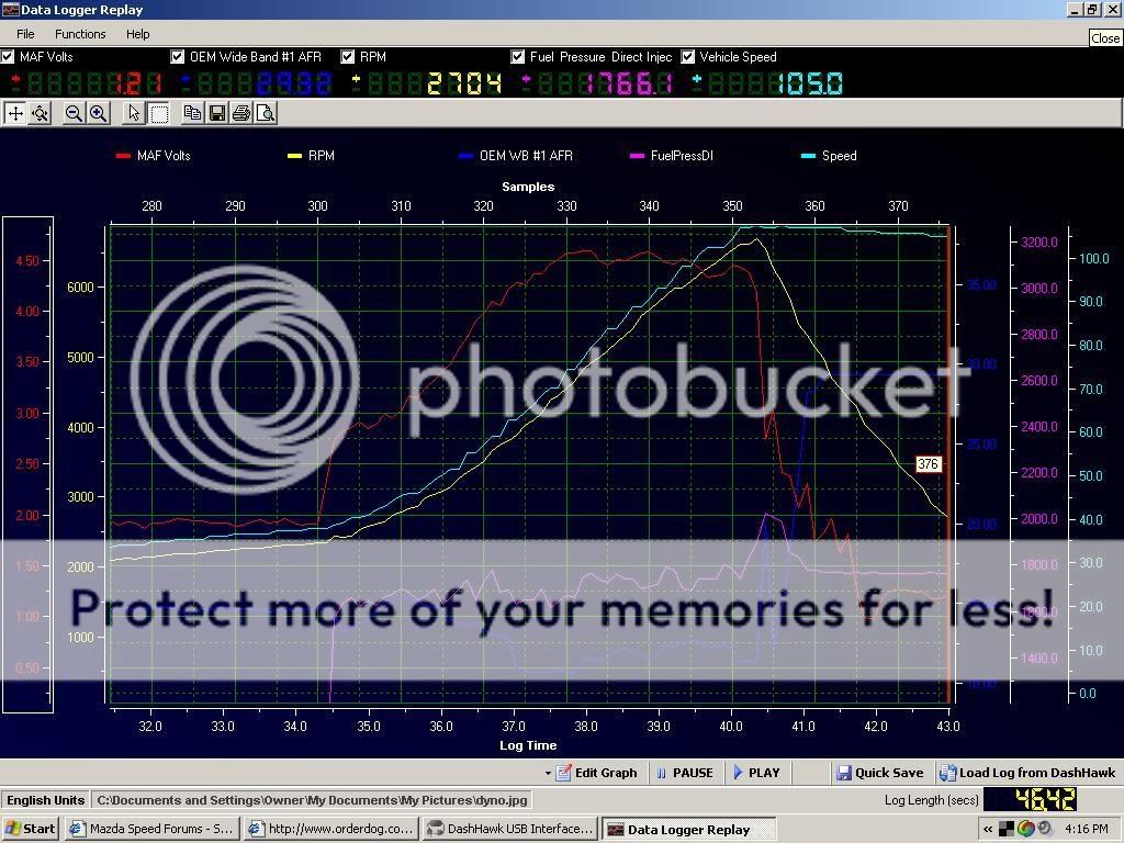

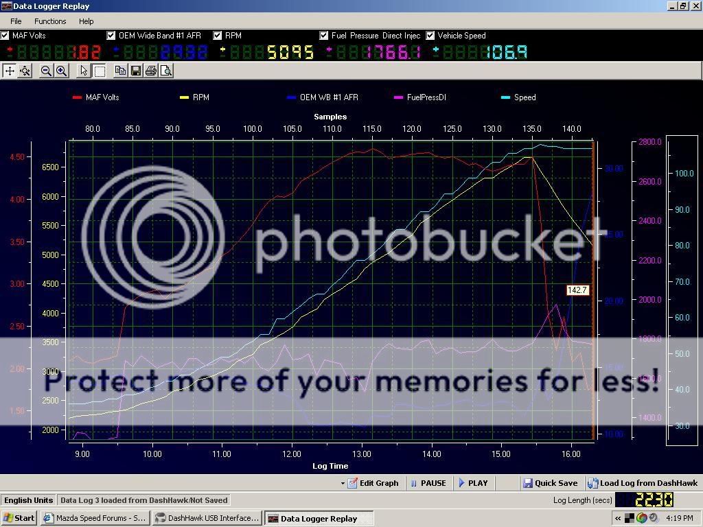

Heres the datalogs.....the first one is the 346/329 run

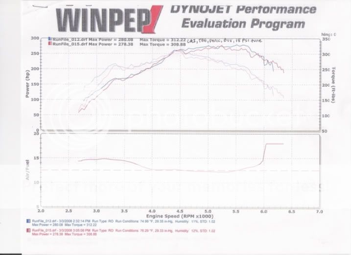

My last dyno before the gt30 on the same dyno is below. This will help for comparison sake. I also upgraded with the inlet kit and PG mani when the turbo went on. Car was also updated with v2 standback..... on this dyno I was tuned at 18psi with the standback v1.
66 whp gained. Srts with this turbo make about 350 whp. ATP on their test mule pulled off about 360in 4th, 375 in 5th. I feel like Im on target. However... I put a new synapse bpv on today as well. It lost boost in the 3800rpm range and up top. The forge(with red spring) held 18 psi like a mfer.
I probably would have made 350 if that torque hadnt dropped when boost dropped. The synapse lost it there and up top too.
