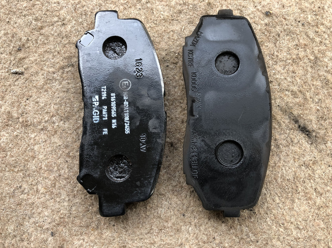

Had the pads out yesterday while fitting the winter wheels. It appears that the front brake on the high powered model is a carry over from the CX7 with twin pistons. Here is a comparison of the pads with the single piston version left and the twin piston version right.

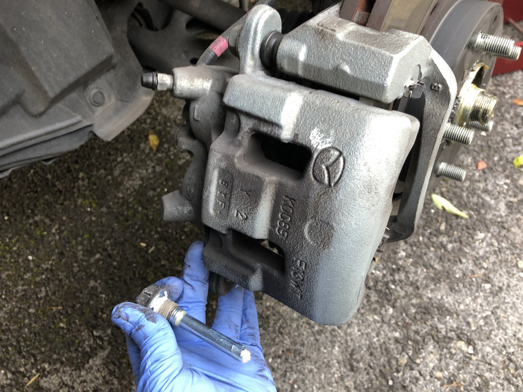

Here you can see the quite unusual step of combining the fixing bolt with the slide pin;
