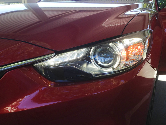

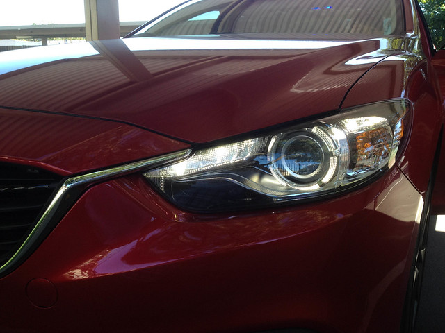

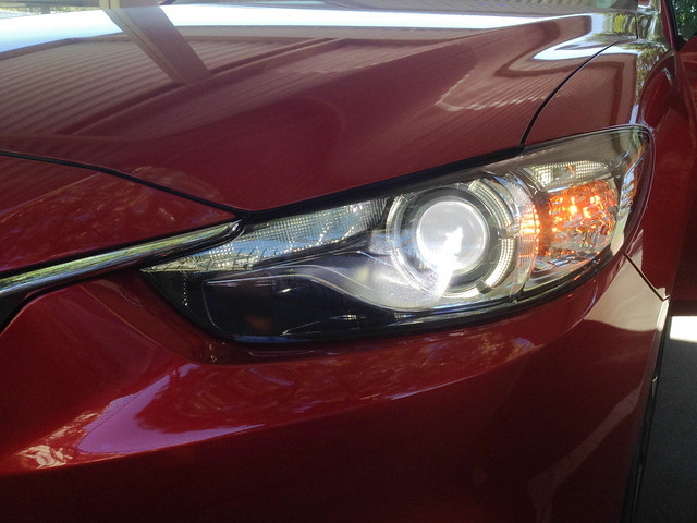

I can't get the angel eyes to come on with the daytime running lights, as shown in this picture on the mazdausa web site in the picture gallery.
Can anyone else get theirs to look like this? If you zoom the picture below called "angel eyes", they are definitely ON without the hid's being on.

You have to turn your parking lights on (which turns on your amber side markers and rear lights as well). I've been trying to figure out how to get them to come on with the DRLs, but I can't figure out the wiring scheme.

To be honest the "Angel eyes" aren't very bright at all. The DRL's completely out shine them. Literally lol. They should have made the Angel eyes produce a much brighter output of light.
I use to think mine weren't working as well, until I looked a bit closer, and realized, oh crap they are on lol. They just aren't very bright.

They are bright when you turn the parking lights on, which is what it looks like in rjayd's pictures and the brochures. I'm still convinced something is working correctly.
mine are very dim and I barely notice them, but they come on with DRLs. Haven't tried to look at them with parking lights.
IIRC, the DRL/Halos don't come on when in park or with the e-brake engaged in any gear. Is that true for the MZ6?
IF they are on at all, they are so dim as to seem like they're NOT on, in my experience. They're on with the HID's, but who cares about that. Not a biggie to me, just wish they were brighter.
Haven't seen many '14 6's on the road. Though I do recall once seeing a GT with its parking lights on and the halo was very noticeable. Seen a few others with only DRL and headlights on and the halo was not noticeable. Obvious why it won't be with the headlight in the on position as the projector light bleeds enough to mask the halos. Though I am wondering if they have a dual stage to them. Dim with DRL, "bright" with parking and so on.
Hi, I just traded in 2010 CX-9 GT with 2014 Mazda6 GT and had the same issue which had me go back to the dealership as well as do a lot of research in the internet...But now I have just discovered the secret that I'd like to share with you (if this was not already known by and clear to you guys!)
I would say that SayNoToPistons already mentioned the true conditions that prevent you from seeing the Mazda6's LED DRLs w/ Angel Eyes normally work when you had to observe the car when it is parked or standing still. From my experiment and observations, Ive got the conclusion that Mazda6 GTs DRLs only operate / light up when the engine is started AND the gear position is not P plus the handbrake is not engaged, regardless of the positions of Light Switch (either OFF or AUTO). This is quite consistent with the intent the car is being intended to be driven and moving. And I think this logic also applies to other new Mazda models like CX-5 and Mazda3.
