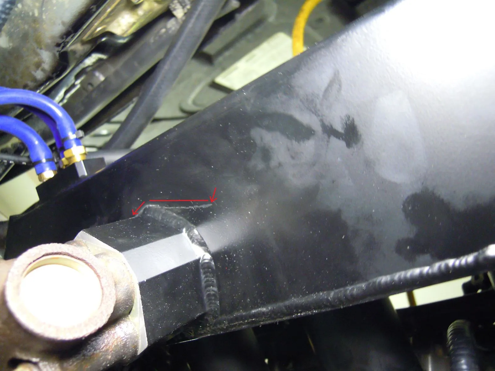

The welds holding the egr block on my manifold have cracked :( I've been chasing a pin-hole leak for about a month now and just found this. Grabbed the block, wiggled it and can see the corner lift slightly.
505 could you please contact me ASAP. I'm pretty worried seeing as I forked over $800 for something that's breaking down after 2 months of use.
edit: upon closer inspection, the crack runs along the weld on the egr block and out about an inch and a half onto the sheet metal. I will have pictures tomorrow.

Ok, here's the best shot I could get with the manifold still on the car. I saw smoke coming from under the hood after I came home one night. Noticed the egr valve was wet with carb cleaner and was dripping down onto the exhaust. I cleaned the egr valve when I swapped everything over in July but never hooked up the tube...everything was fine until recently.
I used my boost leak tester to pressure up the intake and sure enough you can see it leaking out the crack. Makes a funny whistling sound too and pressure bleeds off quite fast. I can't hear it while driving and oddly enough my vacuum reading at idle is -22, that means it's opening up under boost. The crack in the pic continues around the other side of the egr block, I couldnt get the camera to focus at that angle.

I sent the manifold back to Rich today, he is going to take care of everything. My stocker is back on for now so I can still drive...what a downgrade though, haha.
Here are some more shots of the damage for anyone that's interested. There's a crack running around the egr block and also on the weld that runs next the egr. I don't mean to bash Rich's manifold in any way by posting about this issue, it's just for other manifold owners to see. The part itself rocks and I can't wait to get it back on the car again.
