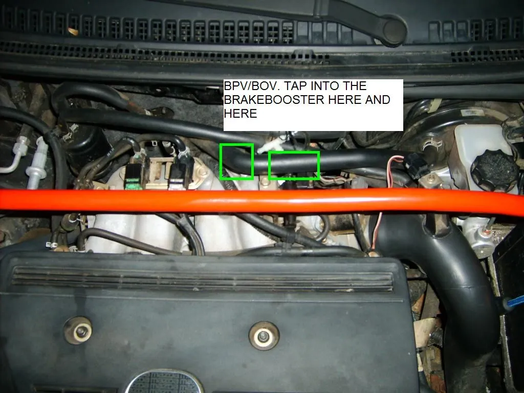

i just got the bov and wanted to know if it was ok to t into the line for my boost gauge running into the manifold? or where else i should put it.
thanks
i did mine off the brakebooster main vacuum line, i ordered the dual valve kit from **********..came with the ts and all..
hope u dont mind i used ur engine pic in my sig..to show people where to tap that s*** lol just had another guy asking about it lol
here use this one.
