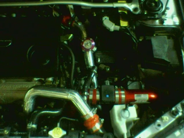

Do you have a picture of your setup?
My BOV is on the IC / Intake pipe. What do i do with the hose the currently connects the BPV to the AEM and the BPV to the IC/Turbo pipe.
DiscreetSpeed said:
hey what psi are you pushing?
do you have a pic of where its mounted?
Im at stock boost.
try this dude...if you have a bc...turn it up to 10 or 12 and go for a drive letting the bov go off...see how loud it is then.
whats that hose there after the bov going to the intake?
thats a big vacumm line...did you have the bpv there and then took it off.
This one?
That is the hose that goes from the IC/Turbo pipe to the BPV then to the Air intake
Ummm...from looking at your pics...I am not seeing a BPV in there?I see the hose from the intake to the upper IC piping but no valve?
Either way it doesnt matter...if your not stalling then you have it set right...Turn up the boost man...you will love it soo much more!

Today i hacked into the brake booster line and setup the BOV and BPV to pull vacuum from it. So the wastegate is on its own vacuum now. The Greddy got a little bit louder, but its still a short whistle and no PSSSSSST.
HELP

Its no problem at all man ... i think i have possibly figured it out now anyway, but im not sure ... i need some validation on this. I think that the stock BPV is diverting so much of the blowoff back into the air system, that almost none of the over pressure is even reaching the BOV, so it doesnt have much to blow off. Changing its vacuum source and giving the wastegate its own source did seem to help a little, but the thing is still way way way too quiet for my taste. I guess its off to jack up the boost. I need to get a profec B spec II first though.
