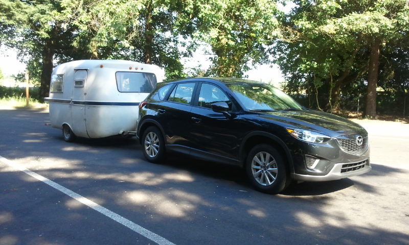

The Cx5 tows a small trailer well.
We installed the Mazda accessory tow hitch and wiring adapter.

Looks like a nice combination. What does the trailer weigh loaded? The trailer also looks to have a fairly smooth and rounded frontal area to help with the wind resistance.

I am curious, is it a Manual or Auto transmission? Man that trailer looks small! My wife was thinking about a little trailer like that. How about a pic of the inside for reference? :)
The Cx5 is a sport model with a manual gearbox. I will see if I can find the weight on the trailer.
-Derrick
The trailer is >1000lbs. I dont have a scale weight for it though. The person doing the towing said it dropped about 10mpg at freeway speeds.
-Derrick
Awesome! I've been thinking about a CX5 as my next vehicle and its good to see someone else towing with it. I'd feel more comfortable if it were rated for 2,500 lbs since my trailer is going to tip the scales just over 2,000 fully loaded but it should handle it. I'm waiting to see if they adjust the towing capacity for the diesel version (if it ever gets released in the US).

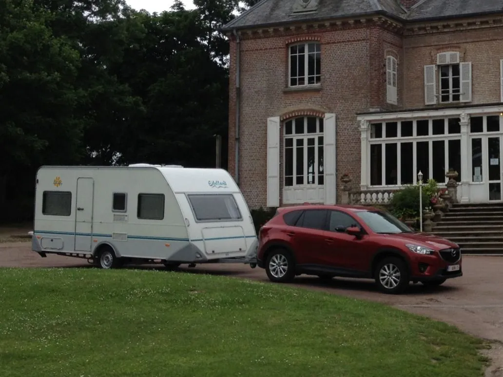

Here another combination.
I tow mine last weekend. It goes very well but when you want to pull it uphill you need to down shift one or two gears to maintain speed.
Fuel consumption was on the way through was 13l/100km with lots of headwind. Coming coming back without wind was 10,8l/100km.
The weight of the caravan loaded was 1300kg. My cx-5 is a petrol 2.0L manual with 165PK.
