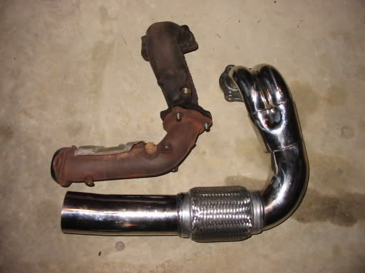

I have the ghl turbo back exhaust on my car. Made a pretty decent gain. Never had it dynoed but I love the way it sounds and would have to say it was worth it. Just by looking at the ghl s pipe next to the stock s pipe I would have to say that the s pipe is by far the most restrictive point in the exhaust. It is TINY.
This [icture doesnt do it justice but you should get the point.
