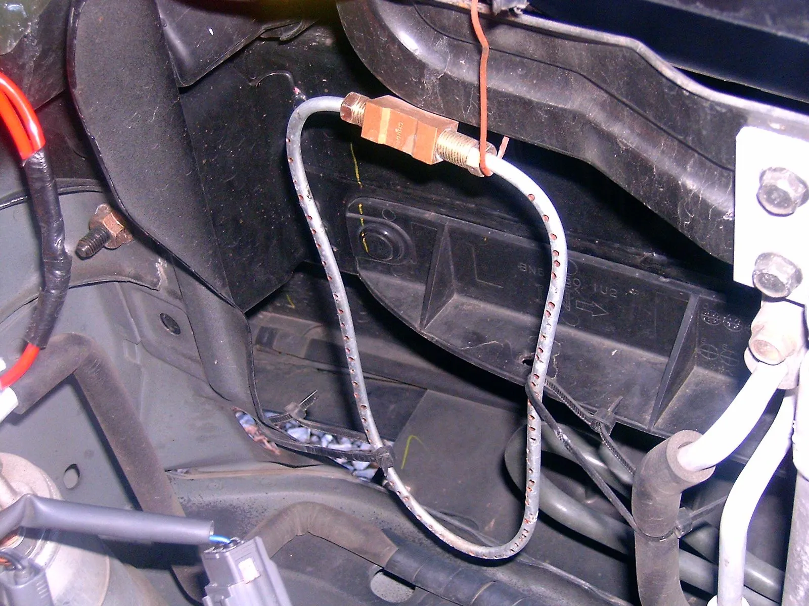

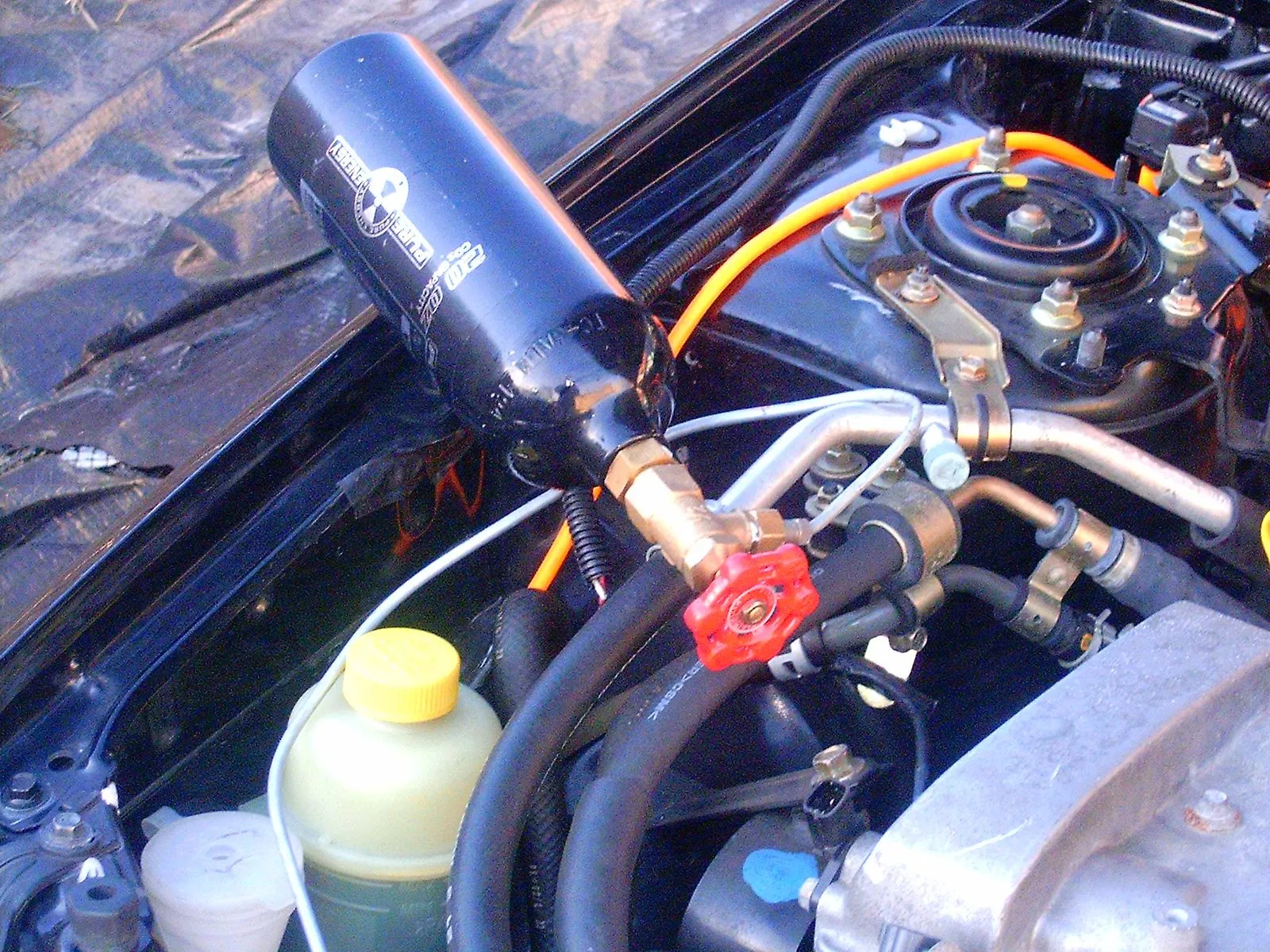

Here is some pics of my current set-up. It's alittle bit different to allow more coverage of the intercooler.
You can see the longer screw cut down inside the valve which activates the schrader valve on the bottle.
And heres my sprayer.
Nope, It's not pretty at all. I usually get 3 runs out of the bottle.
so where did you get the tubing from. looks like brake/fuel lines. and i take it from that setup that you only hook it up, use it, then disconnect it. I get what you are saying about the screw.
i assume its brake lines like you mentioned. that's going to be my method of choice. it's easy to bend and rent a flaring tool (auto zone) and run to home depot and get some brass fittings and you're all set. oh and a drill to make tiny holes for the CO2 to come out (very important step) :)
yeah. The holes take some serious time, I suggest use of a drill press. Yes I use it before a run, then unhook it.
