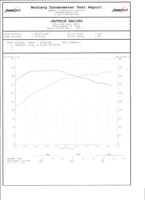

I've made 255 HP and 260 TQ on a Mustang Dyno with MS CAI, Test Pipe, HKS BOV, and Copp AP stage 2 + MSCAI. This was also before i got my inlet pipe installed. I was getting detonation during a few runs because my intercooler wasnt getting enough airflow to cool down the air. I think with proper cooling it could have made a abit more power. I think 300 AWHP could be an easy target with a DP and upgraded intercooler and a few small add-ons like step colder plugs and what not.
