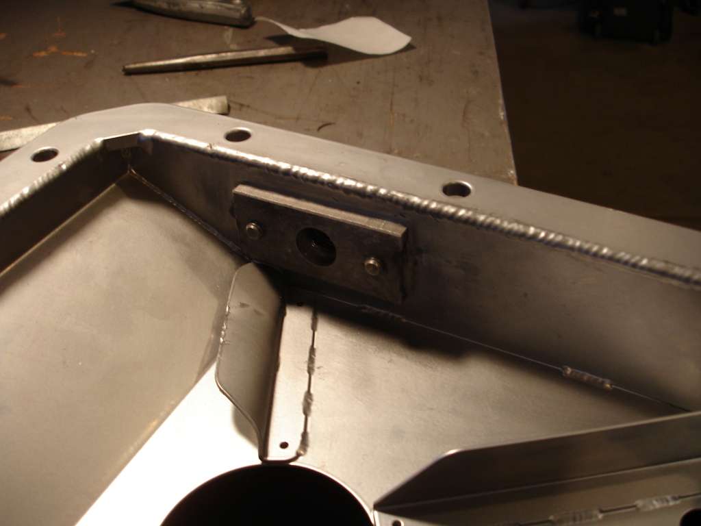

Look at how smooshed your pickup screen is when you take the pan off. With the tube itself only 1/4" off the bottom of the pan you'll see why it's ill advised to run it.
Why get AWR to weld on a bung for you? I just made a return line block out of aluminum and bolted it on. Gives the fitting WAY more threads to bite into, and looks nicer too. Nor will it ever leak.
Drill out the pan. Fabricate aluminum block to accept -10AN return fitting. Note how much thread engagement is now provided. Run through bolts to tapped backplate on the inside of the pan, seal both sides of the block with UltraGrey.
This is WAY overkill, but anyone who has seen my build knows there is no such thing for me.
Definitely looks great!
