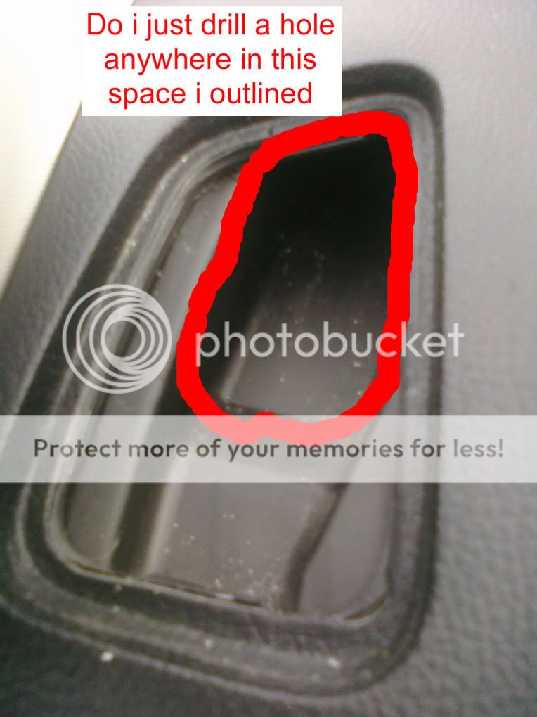

Ok sorry for creating a new thread for this but i couldn't find any info on installing a Boost Gauge in a Speed6. So im installing a boost gauge with the defrost vent pod made by block8head. The questions i have is first where do i drill a hole for the wires to go through i know its in the ducting for the defrost vent but where exactly. Here is a picture explaining what i mean:

I have the same gauge mounted in the same location. I drilled my hole to the left side of your outlined area. The area beneath that spot seemed to be the most open to me. You do have to be careful as it is easy to mar the surface of the dash with your drill motor (it is helpful if you have a long bit).
