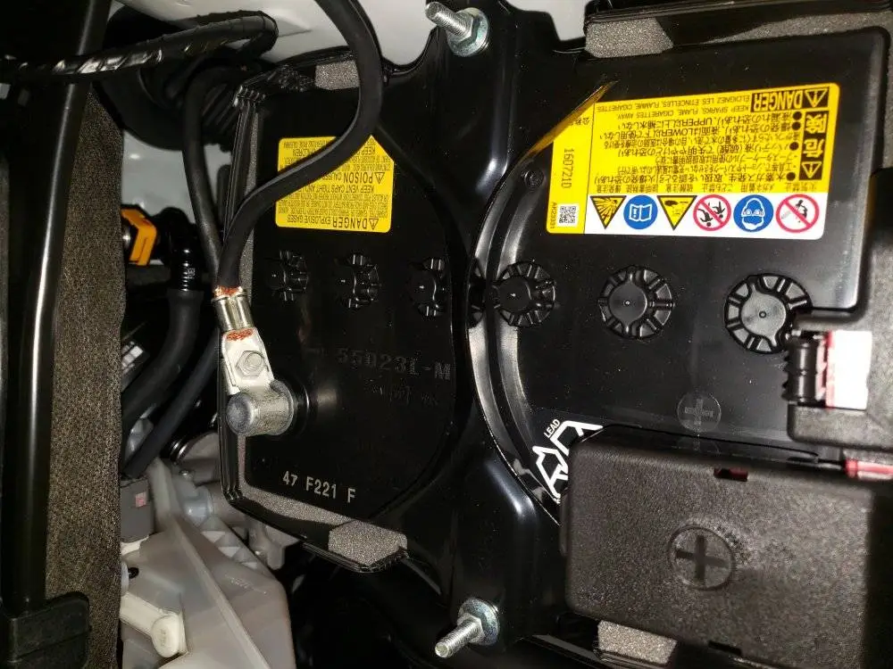

I tried to figure out what kind of battery it is to try to understand how long it's supposed to last with 0.3A consumer but no luck
F221 seems to be the first part of the part number

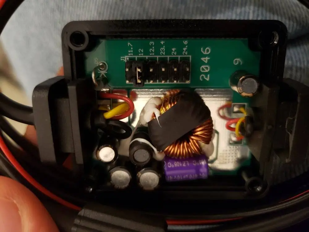

The cable has zero information along with it, the piece of paper it comes with refers to some web address that is another dash cam manual that happens to have a section about cable installation and nothing about the cable itself. The only way to tell that it *hopefully* is going to cut off at certain voltage is by opening it and seeing the jumper. Will set it to 12.3 to see what happens.

I think the battery will be between 40 and 50 amp hours.Using .3A for a week would use 50 Amp hours, so it might last less than a full week.

There's time limiter in the camera itself so I'm using that and it cuts off before voltage goes below 12.3V
