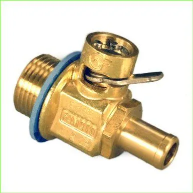

I prefer to use the Fumoto valve for my vehicles, but I don't see an application for the 2014 2.5 Skyactiv-G Mazda 6. The closest I've come to a P/N is the 106N with length adapter, though that was for the 2.0 CX-5 Skyactiv-G, and the recommended adapter was not necessary according to that owner. My question: Has anybody installed a Fumoto in their new '14 "6", and if so, was it a 106/106N with or without adapter? I don't really want this to turn into a discussion ito the merit of the valve itself, just a confirmed application for our cars.

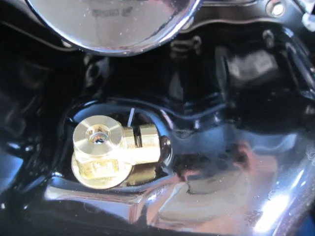

i too have loved having the fumoto valves on my car. will be ordering one soon. i saw this pic which makes me think you might not need the length adapter (probably the ADP-106 or longer ADL-106 Adapter). the N designation is for Nipple, which should be totally optional/personal preference. the threads are 14mm 1.5
Thanks for the response and the image. I assume it's from a '14 "6", and if so, it appears the orientation of the filter is vertical with the ground, in which case the length adapter may actually interfere with the removal of the filter, so I would pass on that. I would go with the F-106N because I prefer the nipple adapter which allows an attachment point to run tubing from the valve to the waste oil container; hence, a much cleaner draining of the used oil. My only "complaint" about the valve is you never really know what position the release lever will end up at rotation-wise when you reach an acceptable torque. One always hopes the release lever ends up facing up and not down toward the ground. The other complaint is the valve does make draining slower than simply removing the OE drain plug, but it's just the nature of the beast. In all my years of buying Fumoto valves, I've never gotten a defective valve or had one fail/leak over time, though it's not unheard of.

i still think you might need the short adapter. let us know, cus i will definitely be ordering one.
Upon closer inspection of the oil pan, you might be right about that. The pertruding chin just north of the oil pan plug may be a problem without the adapter, or it may not. I guess there's only one way to know for sure, and that would be a test monkey (so to speak). I recall reading somewhere that a 2.0 Skyactiv CX-5 owner got away without using the adapter. I'm not sure if it's the same oil pan. I guess I could look it up, but even if the pans are interchangable between the 2.0 and the 2.5 Skyactiv's, it still leaves the chin issue as the unknown.

think i found your answer- http://www.fumotousa.com/faq.htm
How much does the Engine Oil Drain Valve stick out from the oil pan? Is it safe to use the N-Type valve (with Nipple) for cars and light trucks?
A. The Drain Valve for passenger cars and light trucks is approximately 7/8" thick. This means that the valve sticks out only 1/2" more than the regular plug head from the oil pan. The Nipple on the N-Type Valve extends from the valve for 5/8". We do not recommend using the N-Type valve for vehicles with low clearance, as the valve may stick out too far against the ground.

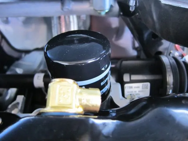

FYI, just in case there are still those that are wondering if a Fumoto F-106 would work, I installed one today with no issues. No adapter necessary. I can't speak for the the F-106N version but the F106 works perfectly.
-Moto
