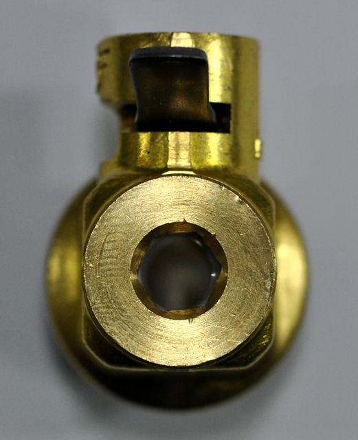

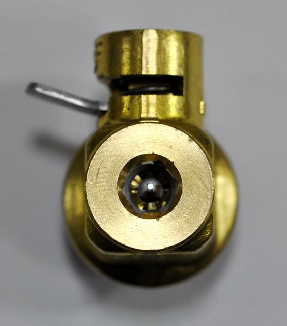

I've used these oil drain valves in my past 5 vehicles and swear by them. The valve number for our CX-5's is F-106. Fumoto states that the adapter is necessary for pan clearance in our CX-5's. After inspection, the extention adapter is not needed. Save yourself seven bucks.
These valves are great for hot oil changes. The only downfall is a slower oil flow. It takes about 10 minutes to fully drain the pan. During this time, however, I can change the filter and have a (cheers)
The valve does not hang below the oil pan nor does it interfere with the plastic oil change cover. The drain lever is indented to prevent accidental movement and drainage.
  • No, I don't work for them.
  • No, I didn't get a free valve.
I just like products that work. Five times now.
F-106 w/o adapter
F-106 w/ adapter (not needed on CX-5)
Open
Closed
