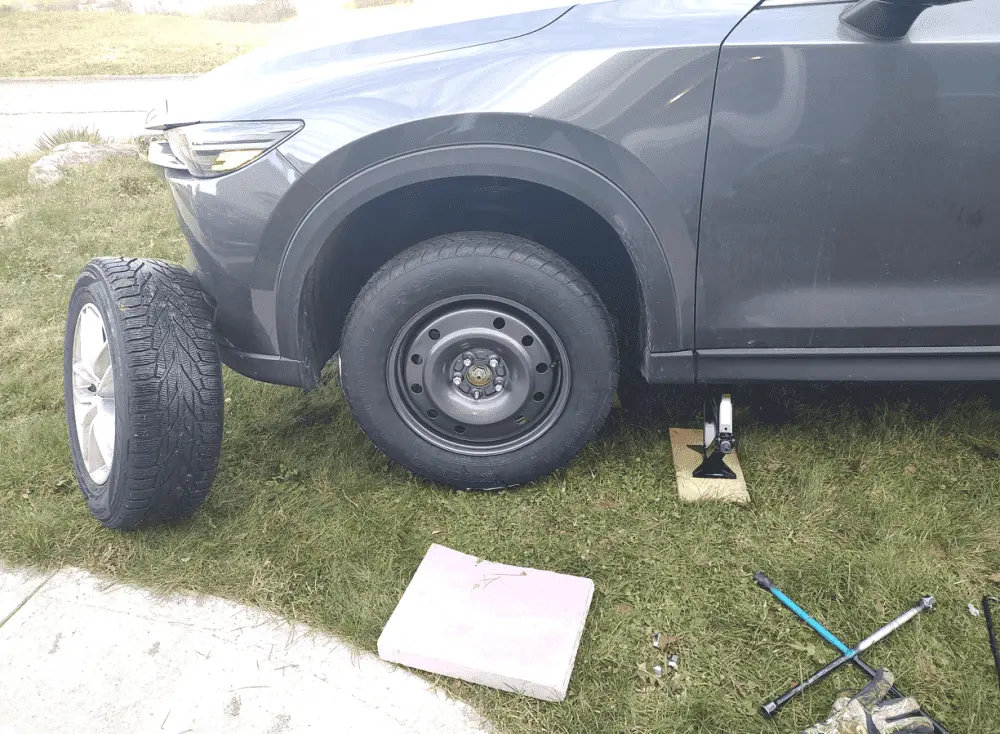

This is from previous post in my sleek and modest offroad mod thread. This is a Kia Sorento 165 90r17 spare rim/tire combo.
I refinished and painted.
It is the next best thing to a full size tire. It's 165 mm wide and just as high as full size. Some older Mazdas and some CX9 also had this size spare. It's the perfect size spare for the vehicle. only had to trim the foam a little and it doesn't raise the trunk panel.
If you can find one online in good shape, buy it. It's worth the $$ to buy and not have to restore rusted one from junkyard.
