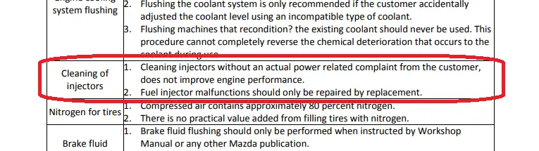

Here's Mazda's official word on fuel injector cleaning:

Notice Mazda's wording "does not improve engine performance". That is not the same as saying using fuel injector treatments in your gas does not prevent degradation of performance over time.
