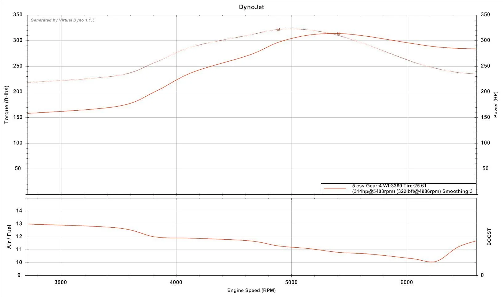

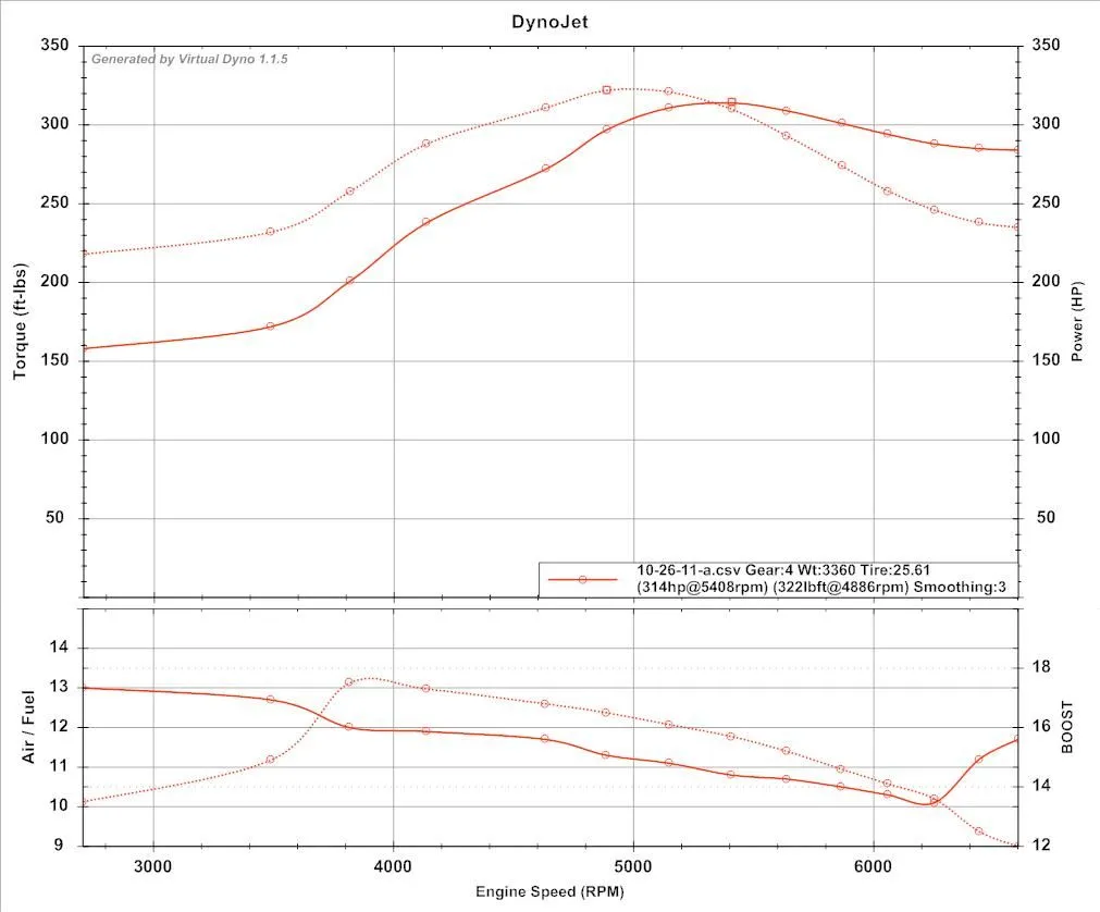

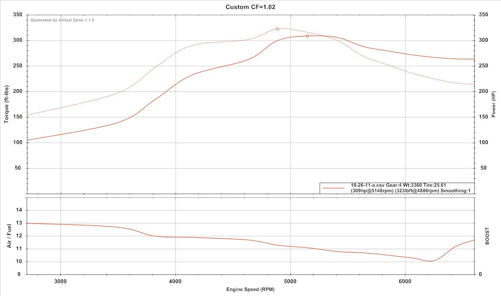

Please see my mods below, which includes a fully catless 3 inch downpipe and catless race pipe, CAI and one step colder plugs Attached is a pdf version of a csv data log made by ScanXL Pro software dongled to the OBD II port and a laptop. Resolution is low as I was logging a lot of other stuff I have edited out to get the essentials on a single page for this reply.
I've also used this data to capture and chart the data in Virtual Dyno, which is also attached.
OP has a Dash Hawk. Perhaps he could post his log for review. No new logs, or WOT driving, however, until the fuel pump is upgraded. Some of us seem to have stouter stock pumps that others. I guess I'm lucky.
In my limited experience with HT and data logging, I find that it can support just about any bolt on mods so long as the fuel pump keeps up and the stock K04 is the only turbo used with it.
There are a lot of OTS stage 2 AP maps not doing as well, and some AP custom tunes that produce no better results, but which push the K04 way to hard with sustained high boost out at redline and AFR's that are too lean to be compatible with this DISI engine's design considerations to purposefully run extremely rich at high rpm to provide combustion chamber/cylinder cooling through that unburned fuel.
Please note that I do not consider Virtual Dyno numbers to be the literal equivalent of a chassis dyno. However, many pro and semi-pro tuners on the MSF board are using this software to make comparisons. It is against those posted logs that I make this comparison. In the absence of meth or E-85 tuning custom tuning on AP, these results hold up pretty well, IMHO.

I'm on stock pump, so I'm not the guy to ask. But I think Chimmike is correct that the Autotech internals are the way to go. That is what I would do if my pressure drops. Autotech has been widely known for years and respected in the VW-Audi forums as the best choice for high pressure fuel pump internals. We use the same internal parts as the do for the high pressure pump in their 2.0L engine.
