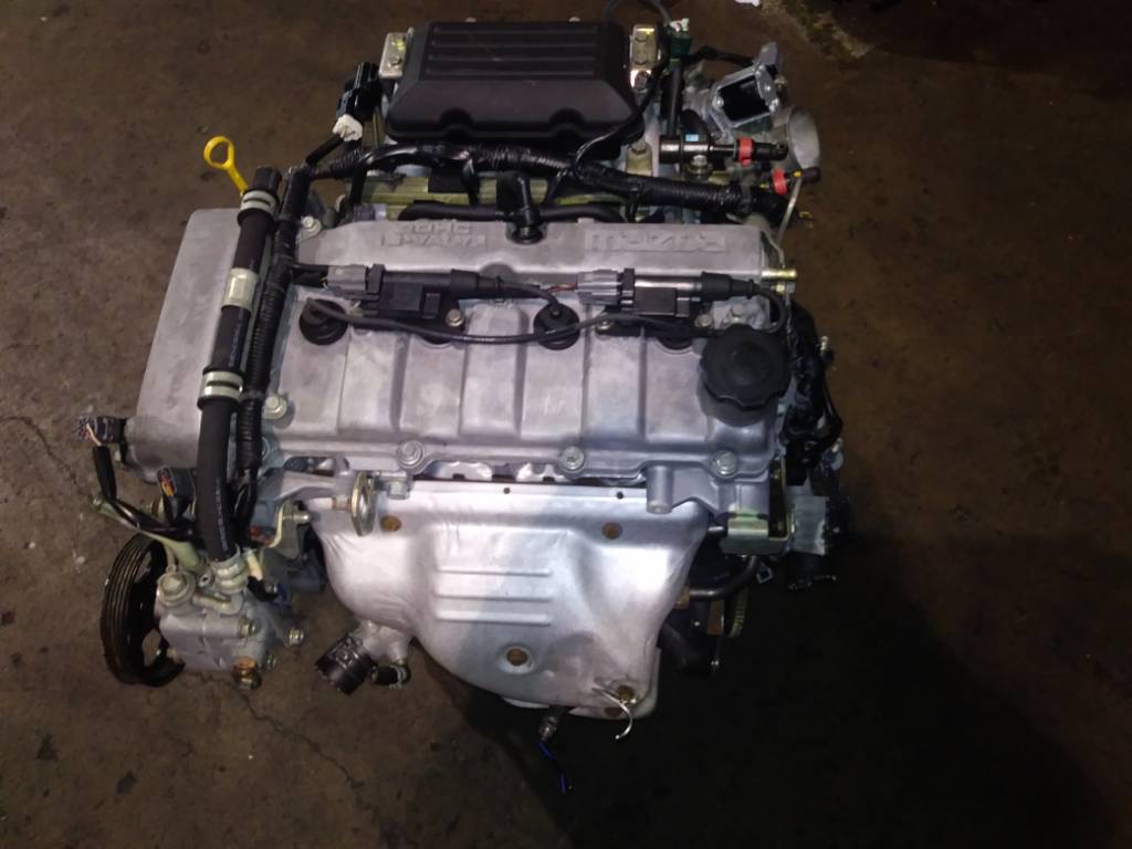

So I picked this up today, and noticed the fpr appears different than the FS DE, how big an issue is this ? Or do I use the FS DE fuel rail and be done with it ?
As well, came attached to an auto transmission. Is there anything one needs to attach to a 5spd manual ?

You will need a new fuel line, the de does not match up, as well as a new wiring harness. Which in turn you will need a new ECU to match the harness and be able to run the ze motor.
In my experience, I got an auto transmission motor and needed to swap to a 5speed manual. With the automatic, there is a seperator plate between the long block and the oil pan. That needs to be removed, after the flywheel has been removed as well.
You got a JDM 626 4WD engine, which has a different FPR... notice the thermostat housing and power steering line are also different
You will want to use your stock FPR so that the fuel pressure matches... if the injectors are not the same color, you'll want to use the stock injectors (same as JDM Protege injectors)
the crank girdle on the auto is different than the manual... you'll end up being able to use only 2 of the 3 starter bolts... you can swap that if you want, but it's some work and it's not completely necessary
you'll need to use the stock crank pulley and knock sensor also

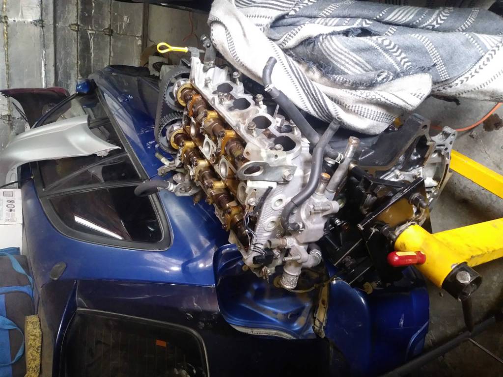

Okay, so into the FS-ZE.
Finally sourced M14 bolts ( 2 x 100mm 2 x 120mm ) and have the engine up on stand.

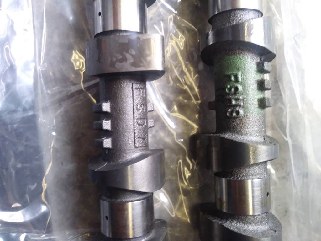

Investigation under the valve cover reveals a not entirely unexpected bit of under-whelming news. This engine as Edwin pointed out came from an all wheel drive and as such equipped with FS-1E intake and exhaust cams. I haven't been able to find much info on these other than they are torque biased ( which I am still uncertain what that might mean in a practical sense to my application ) just that they are not what I want.
I had at some point pulled the cams from a 2001 spicy orange MSP at pick 'n pull and was going to use if I could dig them out of the garage ( needles in hay stack lol ). However to my delight I woke up this morning to find a message from the fellow that build the rally car I just purchased as a donar for my build saying he has 2 new in the box Jspec cam shafts for that car he never got around to installing. A brief negotiation later and I now have cams sorted ! FSH9-12-420 and FSD7 ( as sold by SR motorsports ). Absolutely sick, now the only outstanding issue is the crank pulley, which when the 10 o'clock postman brings me a letter ( and lightweight hydramotor sports pulley ) this engine is green for go !
The fellow who sold me the cams was also happy to share the history of his car and pointed me to some local resources. Great day so far [emoji41]

got pics of the MPV cams? Any chance you can have them measured?
FS1E = MPV FS-DE
FSH9 = FS-ZE and Euro/Aus FS-DE
FSD7 exhaust cam is same as USDM stock
