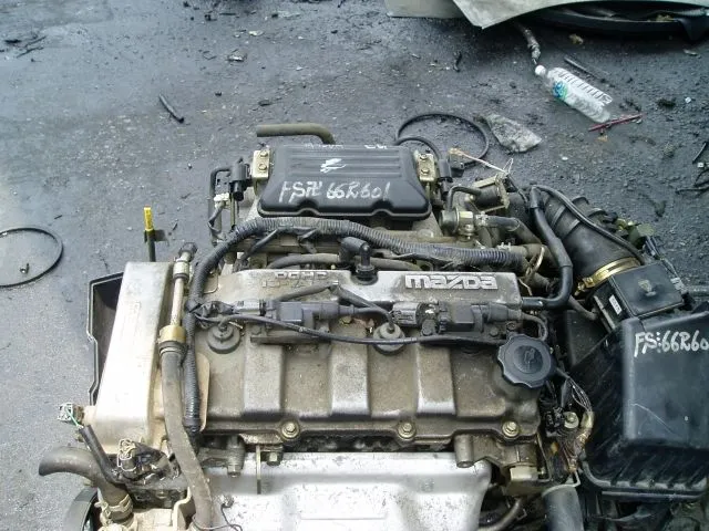

I found a used engine in the local yard. It has auto tranny, but i could tell for sure it it a FS-ZE or FS-DE, if it is a FS-ZE, i want to buy it.

Look for the plenum chamber on the intake manifold.
look at the ignition,does it have coils over the plugs,or does it have them mounted in front of the motor,with longer wires?

it has coil over plug. and a rectangle box on the intake manifold. i'll take the pic this afternoon
The rectangular black box is for the VRIS system... Sounds like you may have found a winner. Hard to say without looking, or looking at what car it came from... What was the car, out of curiosity?
Oh, and guys, FYI, the J-Spec/E-Spec cars had coil over plug after '00 MY, when the US Protege's got it, it's just that the Sport20's from '99-01 were the 3rd gen, early body style, and shared it's coil packs with the 1.8L motor, the remote mount setup.
Here's a picture of what it looks like. This one has the coil packs that indicate that it's a '99 - '00 MY FS-ZE engine:

is this fs-ze? look at pics

yep... looks the same to me.
