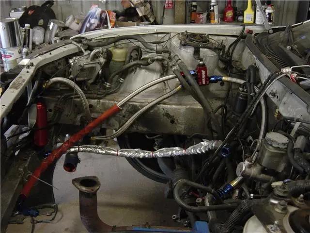

heres mine so far. just temporarily mocked up. oil cooler is mounted in wheel well, lines are AN -12, relocator and fittings bored and shaped for maximum flow and no sharp bends or restrictions. the motor is out and the windage tray is getting the weld in bung for the return line. no doubt the absolute pinnacle of this build. THANx Tom!!

like i said, mocked up. the whole compartment is getting cleaned out and prepped for flat black paint. i still have to modify the radiator support so there will be more welding going on in there. the front sub frame was modded for the oil cooler and supports and thats why it looks like s*** right now.
