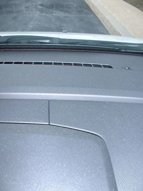

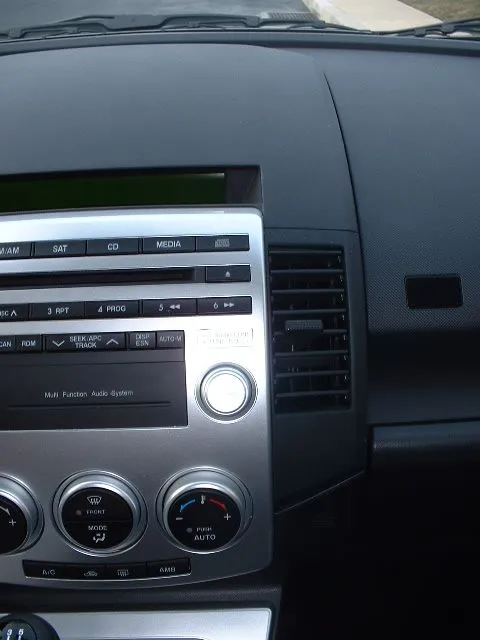

Dash Crease
Yes, my 2007 has that. See the attached pics to make sure it's the same thing you're referring to.

DUDE! You are DA MAN! Thanks for replying and for doing it so GREATLY. Those pics REALLY help and show the EXACT line/seem I was referring to - it's just weird since the original dashboard didn't have the crease at all. Go figure! I am definitely going to take it back for the glove box AND the tapping noise and hopefully they will get it fixed. I just hate seeming like an annoying customer, you know? But, I am really disliking my car right now and this is the car that I fell in love with. I want to love it again.
