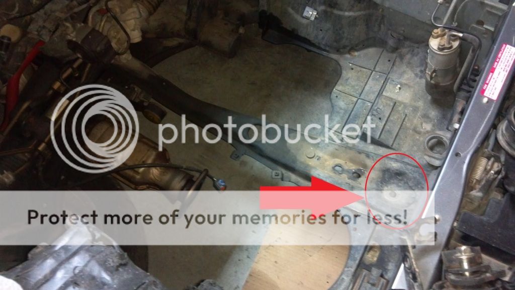

Going to replace front endlinks with moogs. Can't see a front center jackpoint on the car, is there one? Or do you just raise on side put it on a stand then do the other side?
Thanks
The center jack point or the side jack point. I know the side points are right behind the wheel under the doors.
Not sure if thats what your talking about.

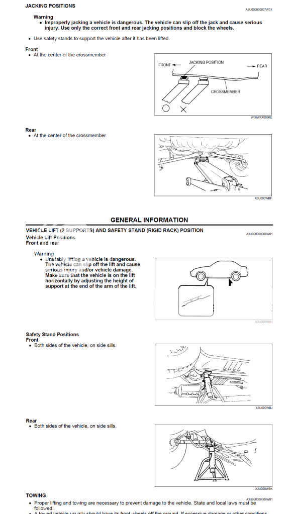

Yup there is one located in the center. Weird looking front beam ( crossmember ) but it's there and should have a bulge/bump on where to jack it from so it doesn't slip. You can jack it up from the front but I would opt for the front side lift points instead as they will lift the body higher than the front. If you are set on the front center jack point then refer to the first image but use jack stands! ( Added pics at post #7 to show location )
Ya thought about the cross member after I posted but who has a jack that could even get to that?
Any jack can. It's not very far from the front. Maybe 1- 1.5 feet. Low profile jack as I have will do it easily.
