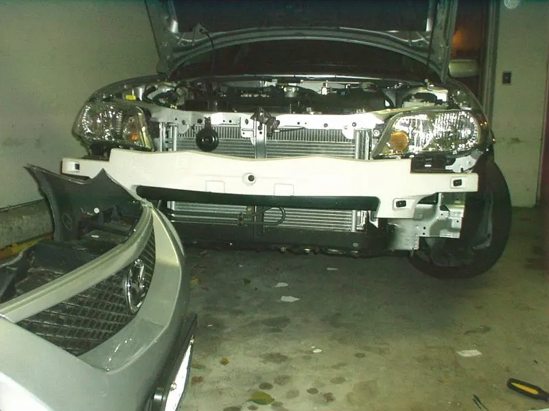

i took this off last night just so i could practice for when i change the amber sidemarker lights and when i ever come around to getting the auto exe grill.
there are too many damn screws, ahhhh!!!!!. Also for the foglights there is like this pivot thing that allows you to change the lights without removing the bumper. I'm sure those of you who have inspected the foglights know what i'm talking about.

for the fogs there is just 1 14mm bolt holding the whole fog light housing in.. you undo that, the unit pops out and there are 2 12mm bolts for adjusting the angle.

Front bumper is taken off by getting at the two phillips screws on each side where the bumper attaches to the front fender. Then there are two "screws" where the top grill attaches to the top "radiator" support, and a few miscellaneous bolts for the underbody plastic cover pieces. Then one electrical connector over by the washer fluid reservoir. Comes off pretty easy, the only pain is the little "clips" right under the corners of the headlights, one of mine is messed up from the factory and it is really hard to release.

yep, got my bumper off in 10 minutes. im a pro now :p
skilletrx, did you get the 2 10mm bolts at the top (i think they are 10mm)
you need to mess around with it...try to angle it towards you and then pull it out, it clips into the bumper itself.
when i just took my bumper off, even i still had a small fit trying to detatch the grill from the bumper....
