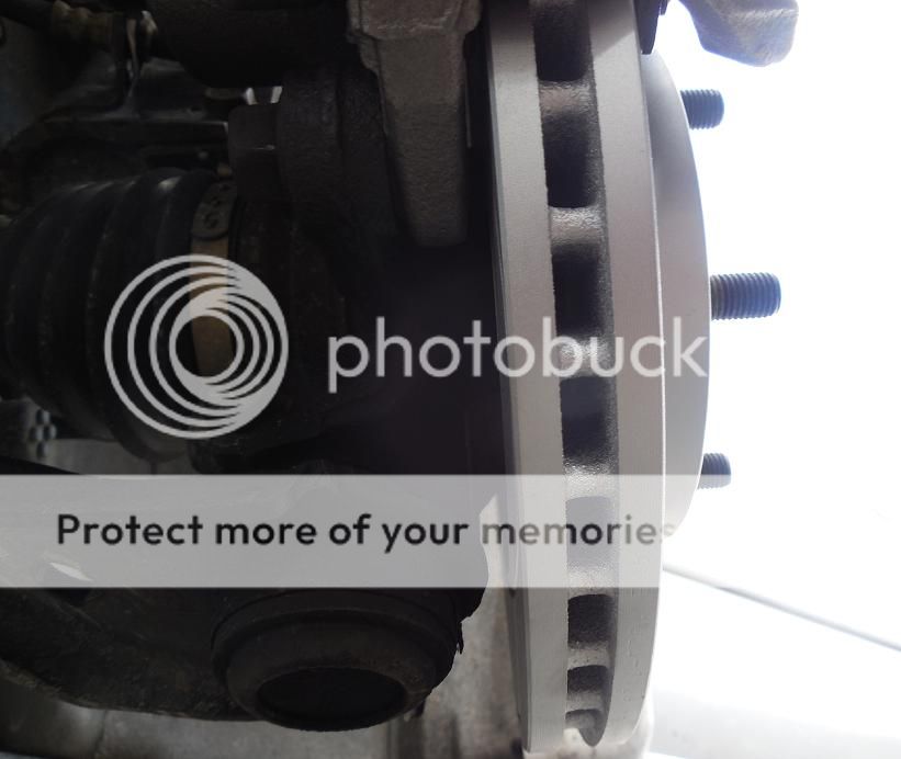

Ok, I finally got all my parts in. Centric calipers, Ate rotors and Centric Posi-quiet pads.
I used PB Blaster and sprayed that on the bolt head area and gap between the caliper and strut; I drew in red arrow marks in the pictures below. I left if for over half an hour and came back and it came off easily. No need for a torch. Here are some general pictures.
I worked on the left/driver's side first.
Left old caliper
left old caliper
right old caliper
right old caliper
disc and caliper from left-side removed.
disc and caliper on left-side installed.
disc and caliper from right-side removed
disc and caliper on right-side installed.

To note, I couldn't fit poth the brake pad clips on the right caliper, but I could on the left caliper. It was molded differently. I compared it to my old caliper and this notch was bigger. Weird. So, I could only install one of the two clips. It was a really tight fit anyway, which is the purpose of the clips anyway, to make the pads fit tight.
You can see the clip here. But, it's not on the bottom side. The two outward-pushing springs are in place.
i actually did the same thing this weekend minus the new rotors and i to ran into the problem with the clip turned out i had them on backwards, those clips are actually curved some what (molded like you said)
