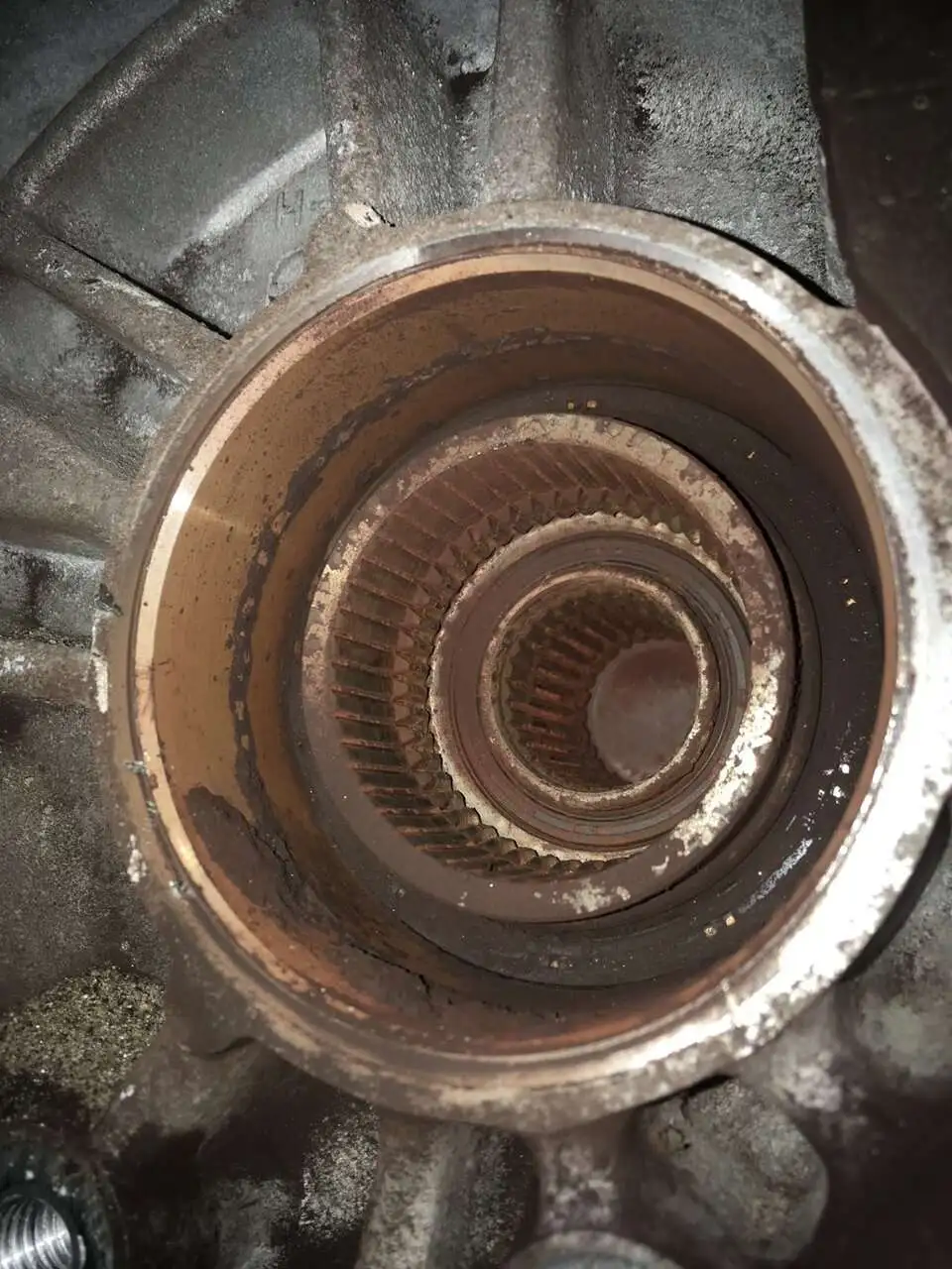

I'm considering doing the transfer case delete on my 2009 cx9. I would like to keep the vehicle long term so one question I have is once the transfer case is gone will there be any parts of the transmission that could be damaged over time due to dirt or rain since they are now exposed to the elements?
Thanks for the reply. So the hole where the transfer case splines insert into to the transmission is sealed on the inside? Am I understanding that correctly?
Also do you think removing the transfer case and driveshaft will cause the rear differential to cause any banging because it isn't fully supported?
Any other concerns or advice? I've been researching this for a while and you're the only person I've found that has successfully completed this and is willing to share, so I really appreciate the help.
here is what it looks like without the transfer case. You can see the transfer case doesn't seal anything with the transmission. Rear diff will support itself but you need to remove the driving shaft from the car obviously. It really is a no brainer modification, you'll see it when you take it out, really not complicated.
