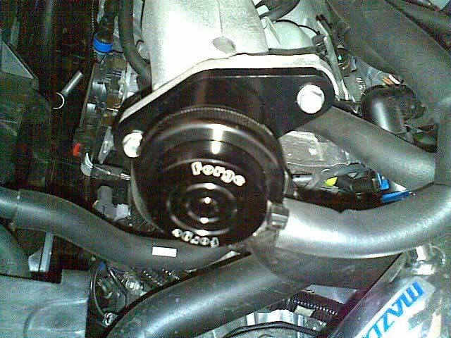

i was not fully pleased with my greddy type s bov, the adjustability was poor. by the time i got it tight enough to seal how i liked, the piston had very little travel, and did not sound good. so i looked for a new valve.... it had to be a recirc style and be adjustable. i found forge and gave them a call. i wanted their direct bolt on valve for the ms3...ms6...and cx-7 (there are no adapter plates to worry about additional leaks) the valves are a ajustable by actually changing the internal spring (very easy). and if you cant decide between 2 springs, you can add shims to them too !!
anyways, i got the valve i wanted and i was asked to test out their new atmospheric valve (vta). at first i didnt want to because i am very anti-vta on this car. well i did it anyway. i was asked to try it out with different spring combos (the vta valve uses 2 springs) and let them know what worked for me and what didnt.
the vta valve is a dual piston design... one to vent the air out.... and one to seal shut at idle to preven surging and stalling. i drove with the vta valve for a week now and........................i hate to say it but .............. its freakin great !!
once i got the spring right (if you order you will not need to worry, it will be sent to you with my recomended set-up) it drove fine ! i did not have any drivability issues what so ever. not even a backfire between shifts, it was really impressive.
it had a nice fluttery whoosh sound to it...nice. it also comes with a nice billet plug and clamp to seal up your now unused recirc hose.
the recirc valve works great as well, and sounds even better when used with a cai.
this model can be purchased in a polished finish or black (the vta model only comes in polished ) this valve lets out a loud whoosh followed by a whistle. it sounds kinda like a HKS valve when it is ran vta.
both valves showed a noticable improvement in spool up time between gear changes. i actually chirped 4th gear for the first time.
