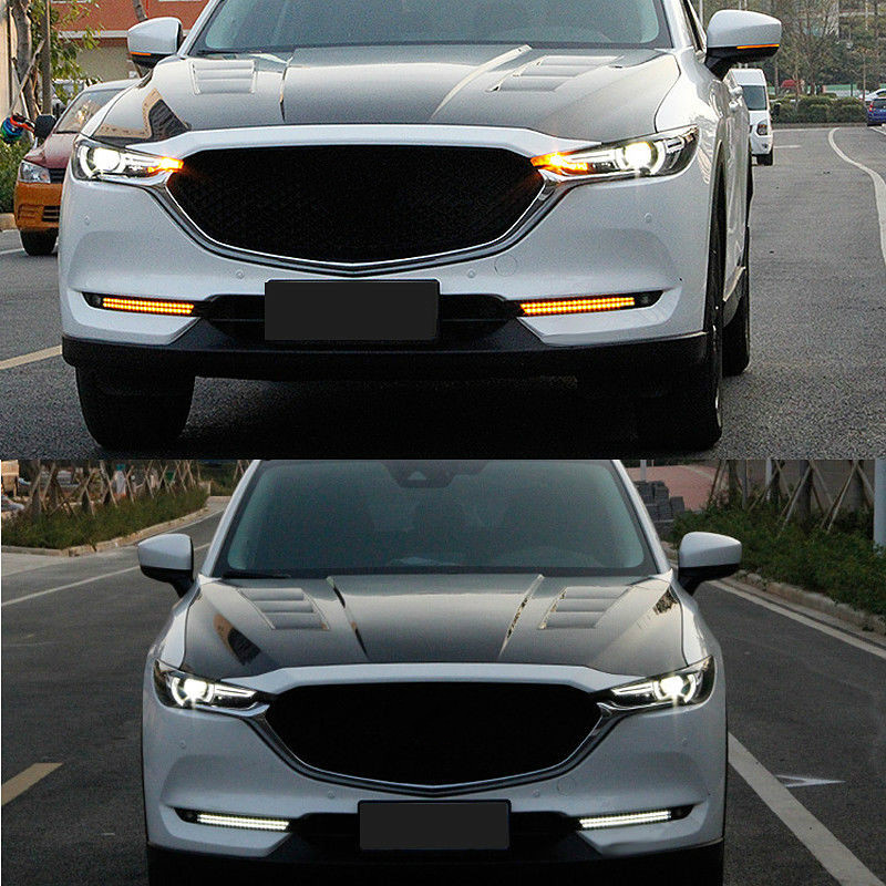

Good afternoon everyone. I ordered a set of Fog Light/Sequential Turn signals off ebay that are set to arrive this week. My goal is to install them this weekend. I dont think they come with instructions, so i was looking to see if anyone could point me in the right direction of a walk thru or videos showing the process of getting the bumper off to tying the wiring in.
I would greatly appreciate any leads.
here are the light i got coming - https://www.ebay.com/itm/2x-LED-Day...e=STRK:MEBIDX:IT&_trksid=p2057872.m2749.l2649

Will these work on a CX 5 without the fogs?
Should work fine since the fog light plastic cover is independent from the longer plastic strip the DRL woul replace. See the photo of part in the ebay ad.
Yeah, some of the eBay listings say not to buy it if there are no fogs. I may just get fogs as well.

If i remember it was four wires for power (battery), ground, turn signal and ACC power.

i have all my parts, the lights and the bezels...
just looking for a wiring diagram as to what to tap into. Anyone?
this is from Member CharlestonMx5:
There are 4 wires. pretty straight forward. long yellow wire goes to positive on left blinker, short to right blinker. I connected the red to the positive of my fog light on the driver side, only two wires there. Then the black is ground, you will find a ground box on the lower driver side fender, it has about 5 black wires running into it and one large bolt to ground them all, I just hooked a T-tap to one of the grounds instead of putting it under the bolt.
