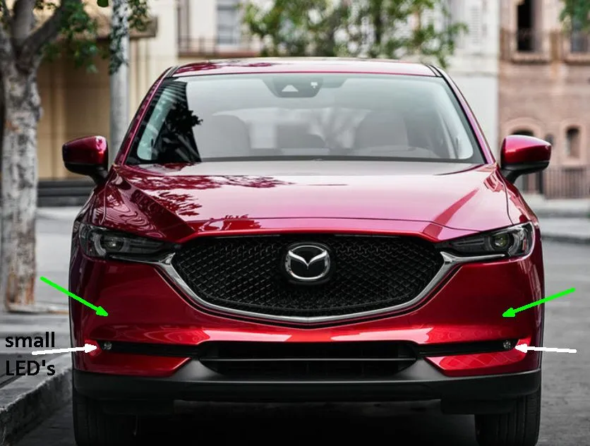

Sidenote, I see the new 2017 CX5 only offers the tiny LED foglight option, so there's no way to add any supplemental lighting like hid kit in that spot unless someone with experience and know how can cut a fog light opening in that 2017 vast plastic bumper space between the headlights and the near bottom foglights (green arrows), then there's the question of mounting the new foglight bracket, not straightforward.
