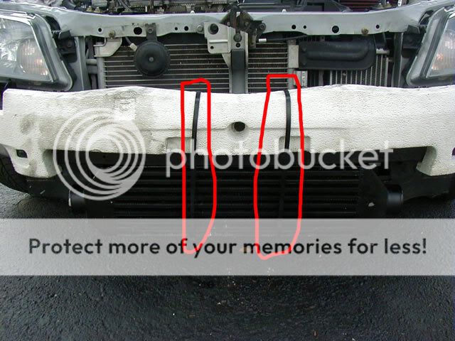

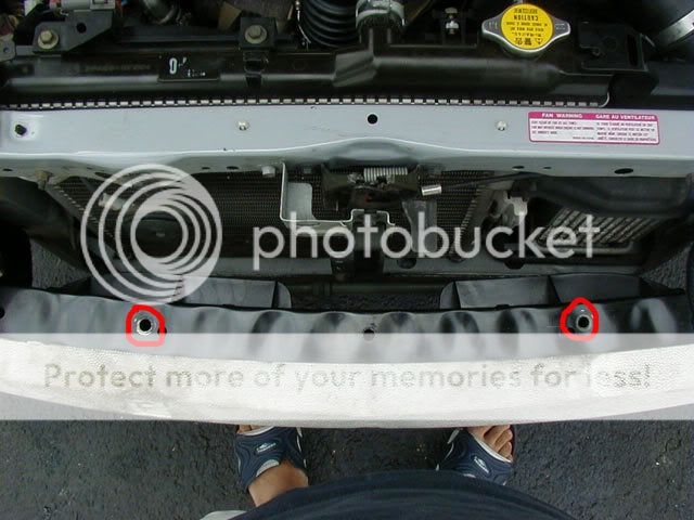

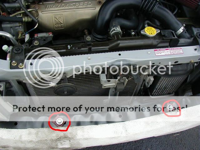

Well yeah, after having the intercooler laying around for a while I finally decided to install it. I gathered a few friends to help me get it on the car and after a few hours of work we finally did it.
The first three pics show where I drilled the holes on the bumper support / crash bar. It also had a middle section that had to be drilled. Then after that I just unbolted the crash bar and drilled holes from the bottom also. I had to get 5'' long screw from home depot to make sure I could go all the way thru to make sure the intercooler stayed in place. After a lot of drilling, and a few drill bits later this is what I got.

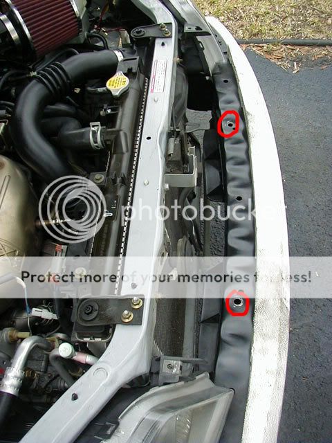

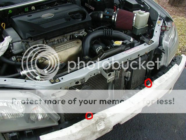

This one shows the intercooler already bolted. I cut off a little bit off one of the extra couplers I have to make sure the bolts dont rattle. (metal + metal = annoying noise)
Here's how the intercooler looked after it was bolted to the bar.
Then I still didnt feel like it was going to stay in place and with all the vibration from daily driving the car, I knew I needed something else to make sure it wasnt gonna fall on the street while driving so I bought a few long zip tides and tied them around the fmic.

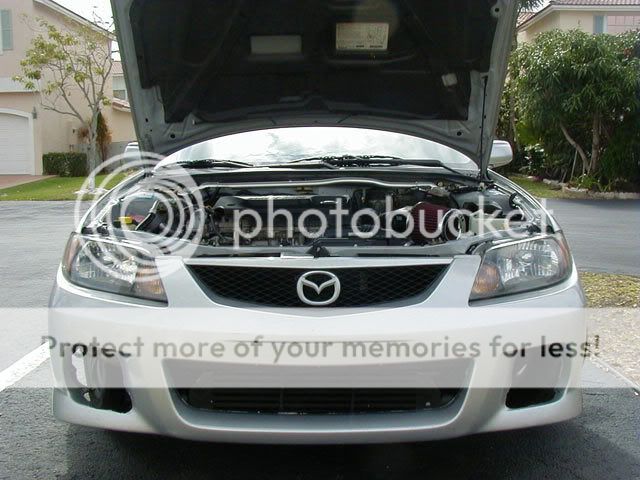

Heres the last picture of how it looks with the bumper on.
PS: Yes, I painted the intercooler black since I'm going for that sleeper look, but I still need to get the mesh that goes there to make it even harder to spot.
