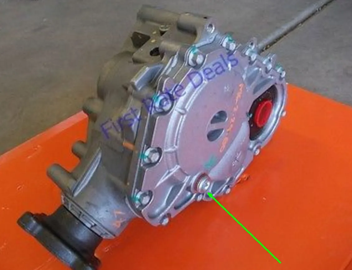

can someone please confirm this is the transfer case filler plug (green arrow) ?
I'm worried about the infamous transfer case failure and want to be proactive and perform regular fluid maintenance. So is everyone who is doing this maintenance using Red Line 75W140 fluid ?
also, does anyone know if the Mazda dealership perform a service to change the transfer case oil, from what I have read,
there's no way the transfer case oil should be treated as a lifetime fluid and it should be replaced regularly.
Thanks very much in advance.
