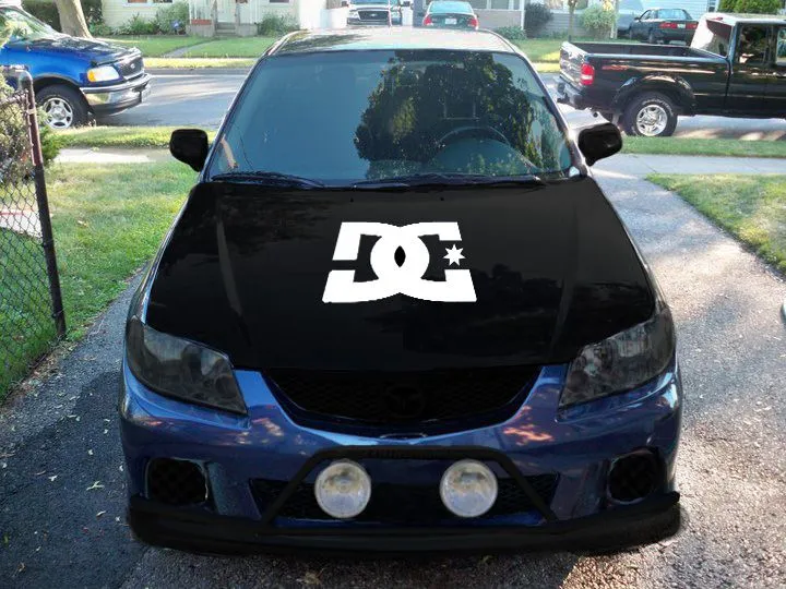

okay.. so i know my photoshop skills are the best, but here's what i've managed to come up with for what i'd like my MP5 to look like.
as you can see, very rally inspired.
let me know what you guys think.
^ Doesn't look all that bad. I would go with the DG lip for that setup, and I would highly suggest blacking out your headlights as well.
Ya that picture is a little sloppy, but i added the 2003.5 msp lip.
But i hear those are impossible to find now.
So I'll prob just get the DG lip.
I'll be adding that and painting the hood after the winter over here.

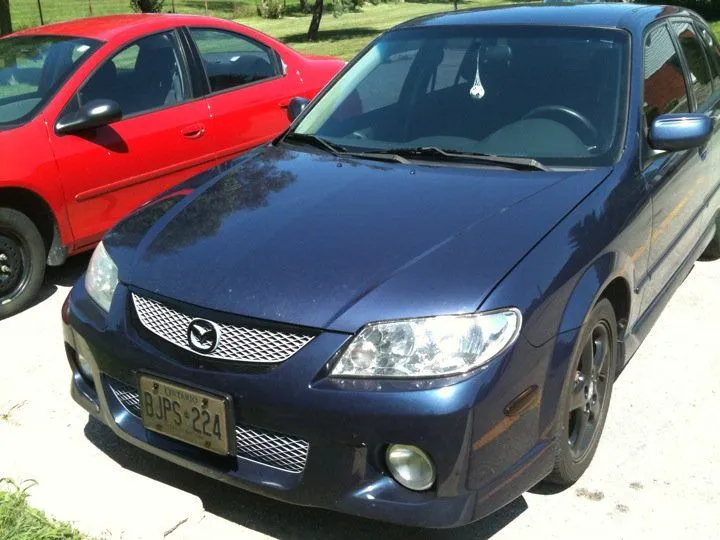

Very clean P5, very nice. How did you do your rims? Where they the stock chrome when you got the car? I have an 02 P5 whith chrome that is getting nasty. I cant find anything decent in my area so I was thinking of some paint myself. I just dont want it to flake off in a month.
Yeah those are the stock illuminum wheels it came with, and they were so garbage and I don't have the money right now to drop on rims..
So here's what me and my buddy did for the afternoon
- wash em up nicely
- sand with some corse paper (I think I used 150...idk!)
- wire wheel the tight areas
- sand over everything with fine sandpaper to get rid of the big scratches etc.
- 1 or 2 coats of primer (not regular primer, it has to be this special primer for aluminum)
- paint with either rim paint or engine paint (I did engine because the rim paint was only in flat black)
- clear coat with rim paint
And wa la!
Took a long long time, but it makes the biggest difference for a fraction of the price.
Also I've had these rims painted for..3 or more months now and they still look great.

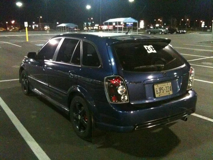

Here it is finally! an updated picture.
took this last night, and its already kind of an old picture.
because since that picture i added my front lip on this morning.
but ill have to take a picture of that some other time.
since my last post the only things that i have done would be
- front Lip
- Altezza rear lights (thinking of MAYBE tinting them just a bit, but im gonna leave them the way they are for now)
- Blacked out interior
- reupholstered my doors (blue) to match the new floor matts
- 2 10inch subs
- mud flaps
- replaced some engine parts (OEM stuff, so nothing to brag about)
- Replaced rotors and brake pads (no more rusty looking brakes)
i guess that's all.
