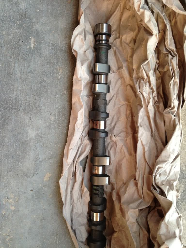

I was also thinking while I have most of the engine apart for that job I was considering changing out the cams for something with a little more, power.
Any recommendations? Also Is it possible to only have say for example: just the intake cam changed out for something other then stock? Or would I have to change out both?
Also, Rico if you are reading this..you bastard...you beat me to that intake cam that was for sale -.- lol!
you're in luck i noticed earlier rico has his car FS, you should be able to get that cam now.
