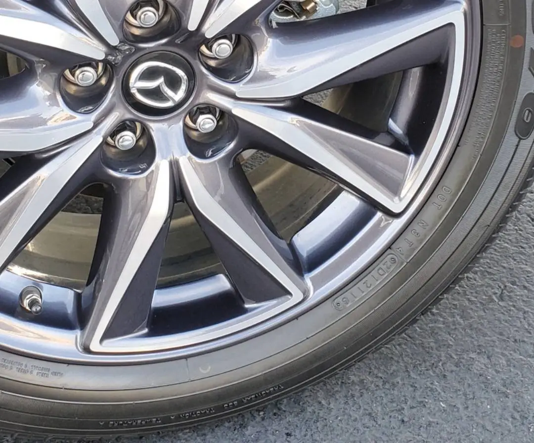

First new tires for my 2019 CX-5 Signature
I got a cheap tire tread depth gauge, as advised, and they measured 2/32. I have no idea what would have worn them down so quickly, but they definitely need to be replaced.

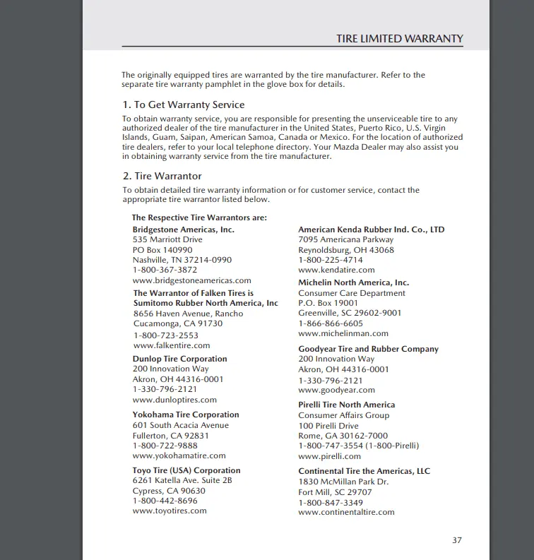

Of course they come with a Toyo warranty. If you are the original purchaser as the warranty normally does not follow the tire.
You can find all the manuals / warranty information for your Mazda here:
Here is an example of the 2021 CX-5
page 37

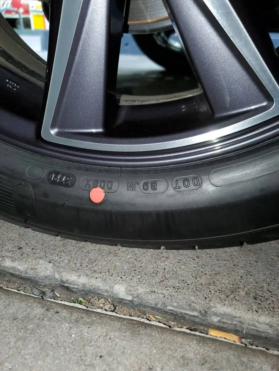

Are you referring to the red dot?
Always wondered whats that about.
my previous (default oem Toyo) also had a yellow (bottom of the picture and barely visible) and red dots. The new michelin seems to have only 1 red.

The red and yellow dots on the sidewalls of your new tires aid the installer in balancing the tire properly. The red dot lines up with the valve stem and marks the heaviest spot on the tire. The yellow dot indicates the lightest spot.
The red dot indicates the tire's high point. Most of the time, a wheel will also have a dot—either a drilled dot or a sticker to indicate its low point. If you have these marks, you should align the red dot with the mark on the wheel. By doing this, you minimize the vibration caused by the high point of the tire.
My understanding is that all tires come from the factory with a mark on them which dictates how the tire should be oriented on the rim relative to the valve stem. Any good tire installer will pay attention to this to ensure the tire ends up with the least amount of wheel weights added during balancing.
Not quite accurate, and the post immediately above mine is incorrect. The red dot indicates the tire’s high point. Most wheels will have a mark or sticker indicating their low point. To minimize vibration, the two marks should align.
The yellow mark indicates the lightest point on the tire. This should be aligned with the valve stem, which is usually the heaviest point on the wheel.
