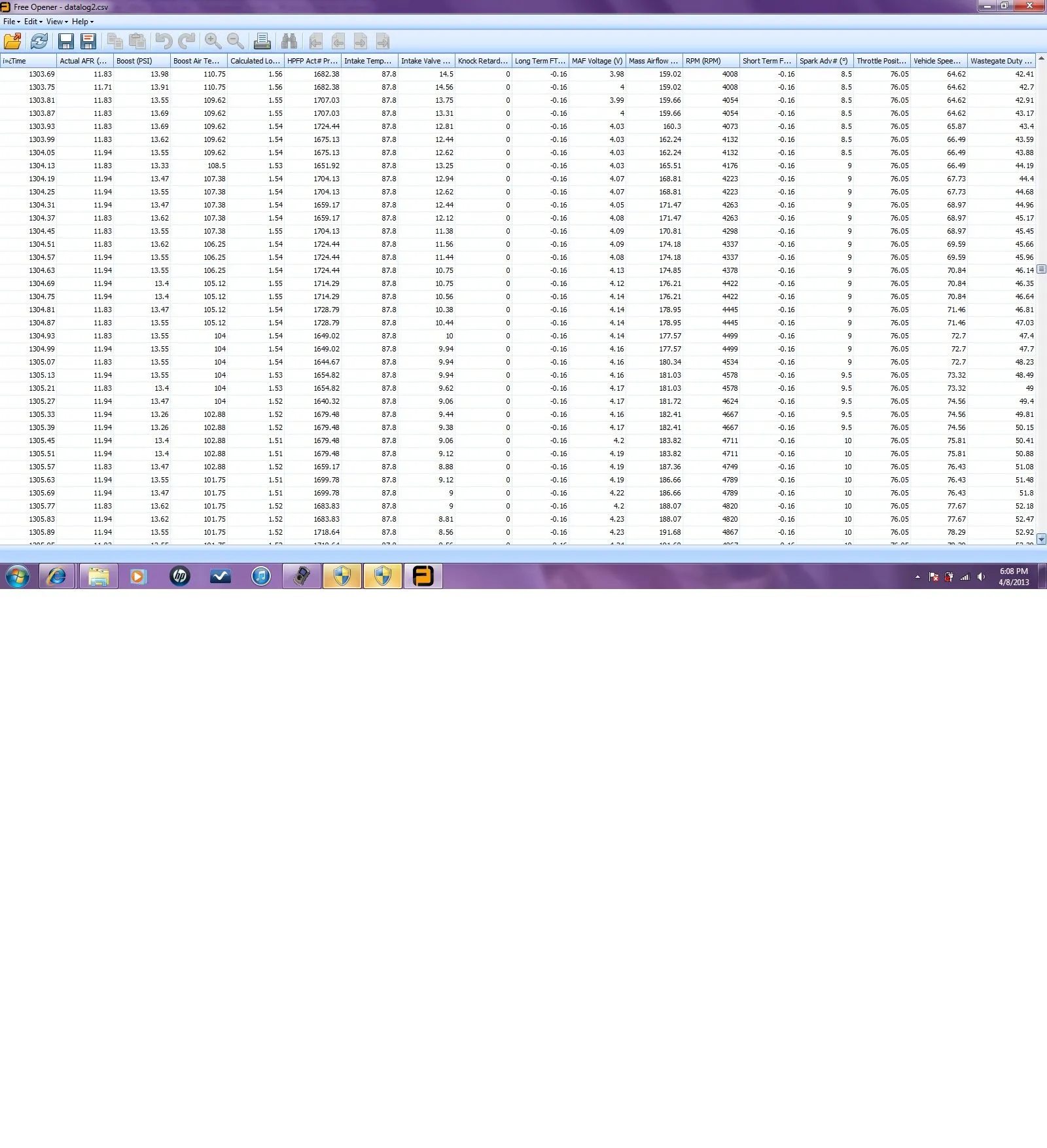

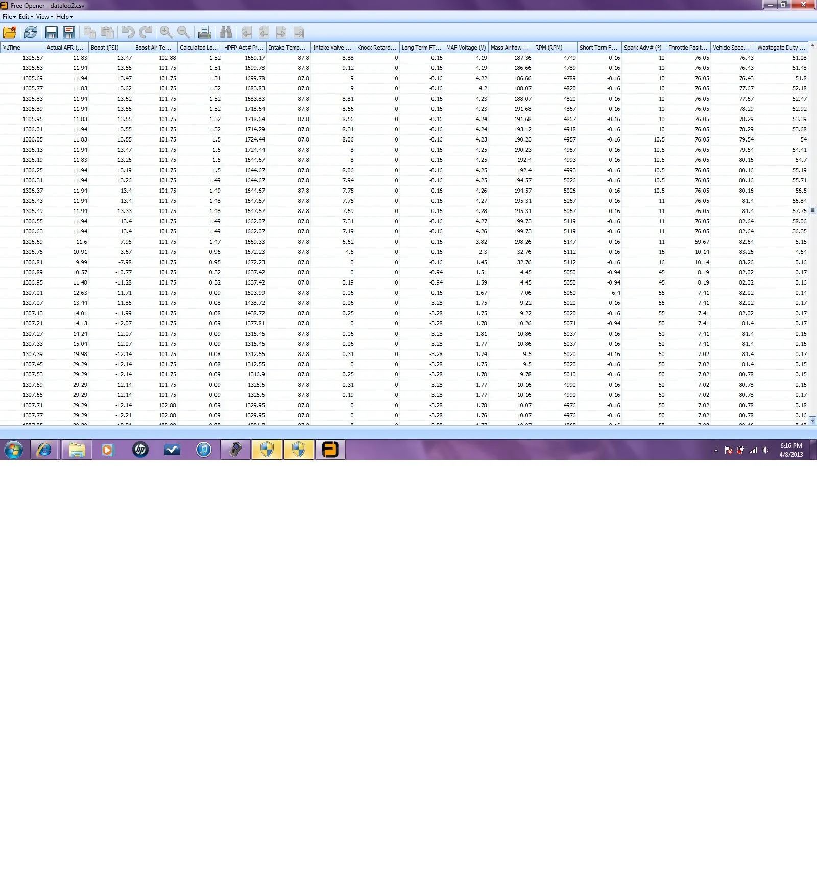

First day with cobb ap. Need help reading log.
Btrend
Got the jist of it reading the table. A couple of KNR around two when i accelerated hard and quickly let off the gas and also on bumpy roads.
Target boost with stage 1 91 oct is 16.5 but as you can see its only 13 ish. holds it when WOT. and the duty cycle is around 50%. Gonna check for boost leaks tommorrow. Any suggestions or comments looking at this chart?

Have you completed scaling the MAF? Your AFRs look really lean for what map you should be running.
