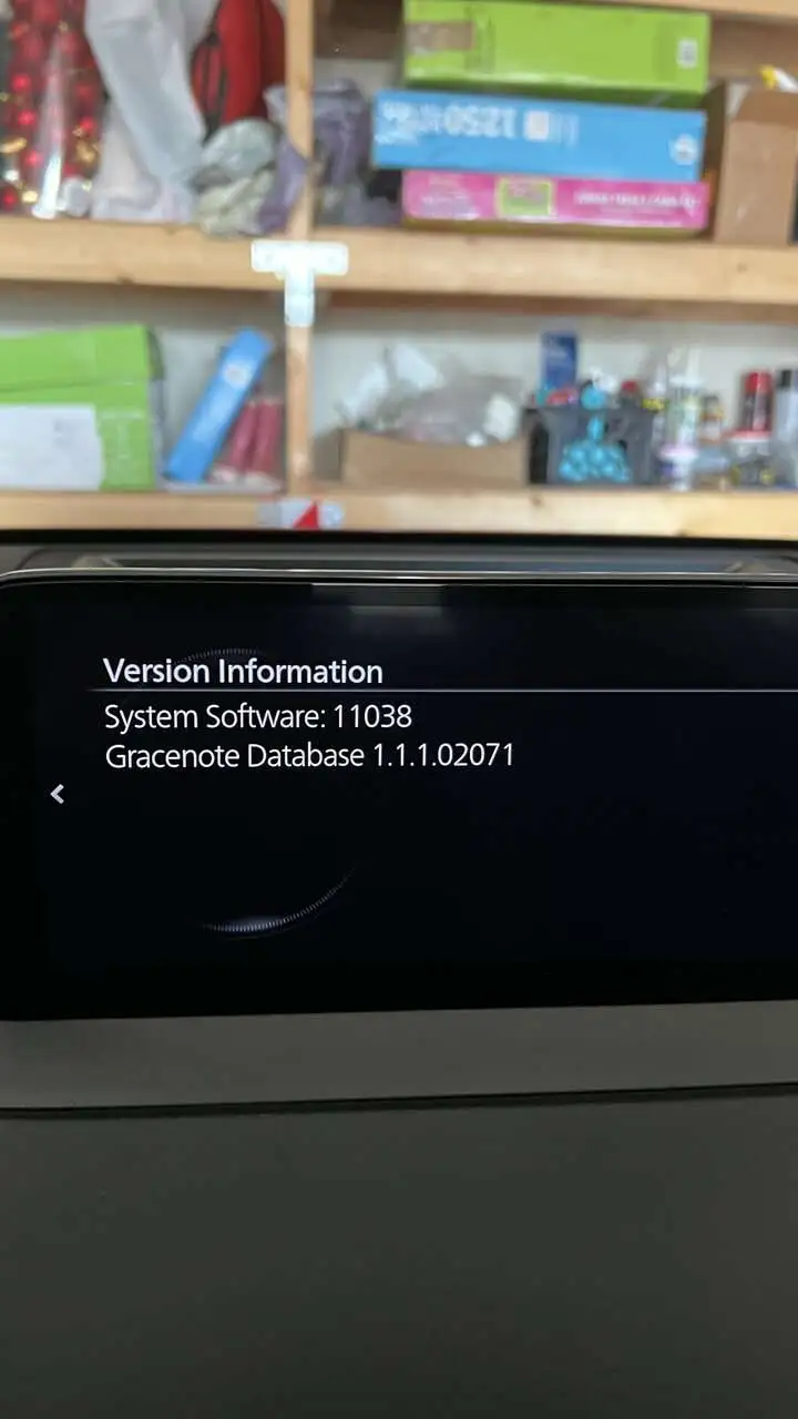

To find out what version is in your car now do the following..
GEN 7.
1. Turn the ignition to ACC or to ON.
2. Select ”Settings” on the Home screen.
3. Select “System Setting”.
4. Select “System Information”.
5. Select “Version Information”.
6. See 'System Software'
Version Number like 11007 is revealed.

Hi, please can you advise how i can update software myself. I have version 11038 on 2022.5 cx5. The software is the same.

Hi ASH8! Can you please help me with the latest software version for my 2022 Mazda CX 9? (I believe that is 1140 while my CX 9 version is 1138).
Thank you in advance!
Same, how's your voice recognition. Our 22s vr has deteriorated to horrible now and it only has 5.5k miles. I took to dealer asking for an update to fix, and they said there wasn't an issue. If yours works better with new firmware, im taking it back.
