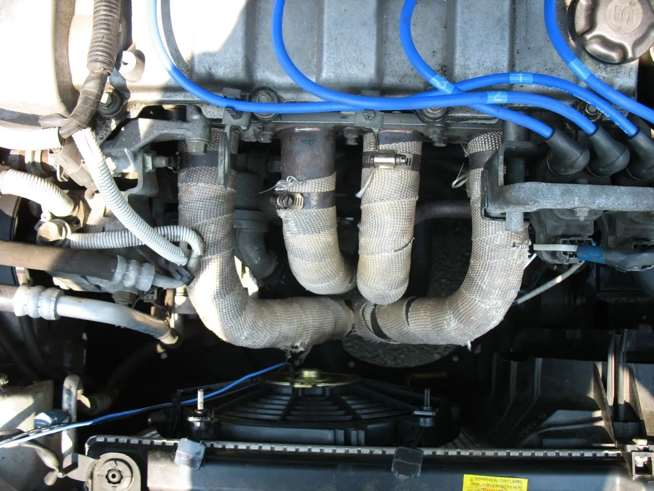

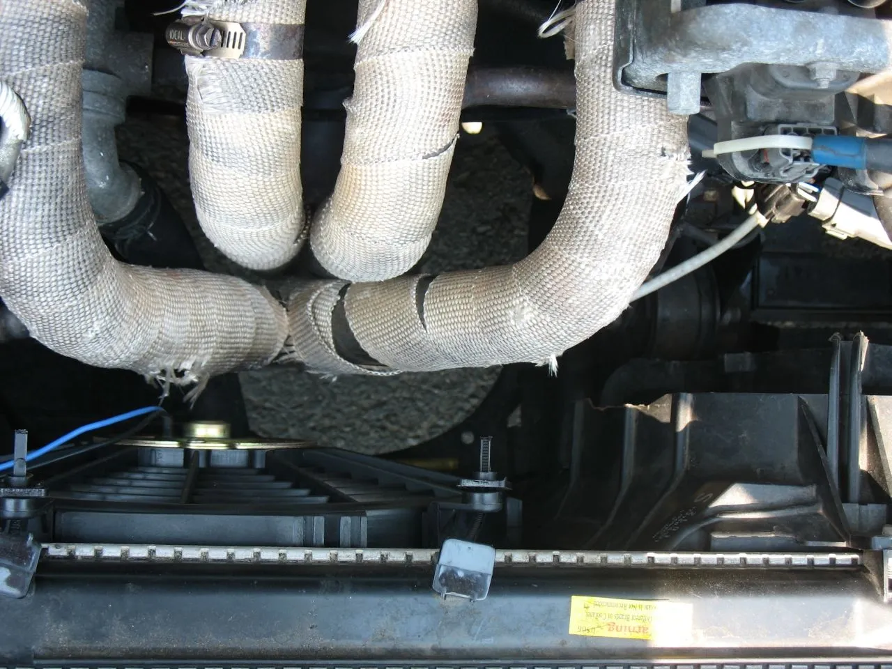

The awr header with thermal wrapping on it. Thanx Craig,

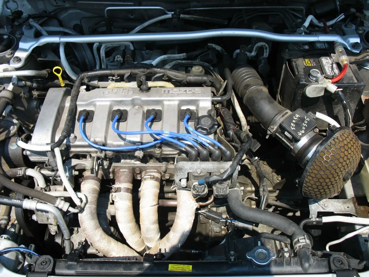

The 12 inch slim fan, works really well.

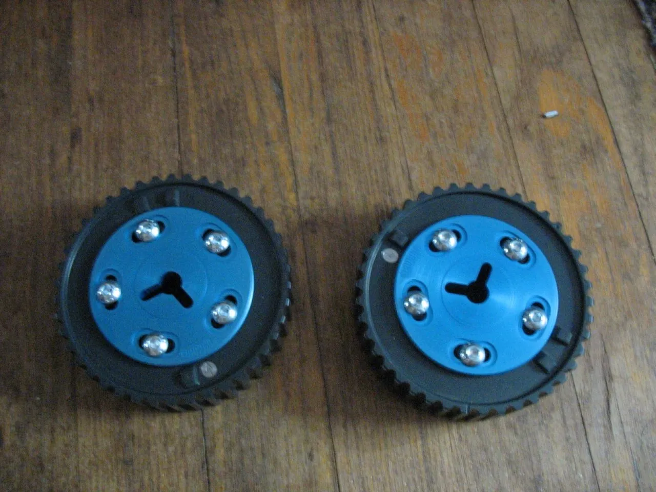

Cam gears that Ill wait until I get my cams regrinded. HEHE.

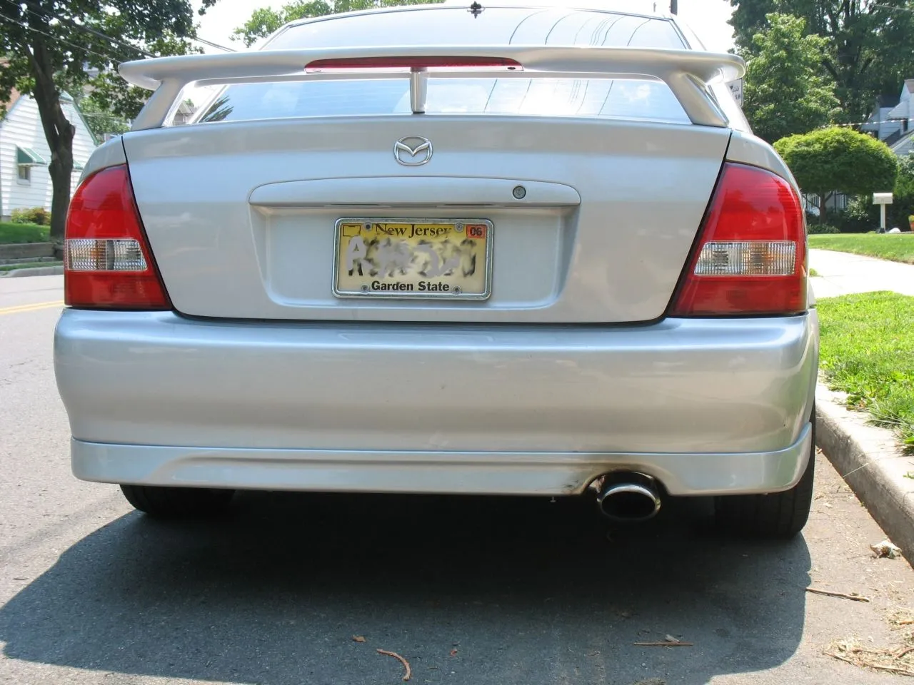

And since the exhaust is annoyingly loud cuz its catless, Until next week when I put the high flow cat in, I put this RB muffler on yesterday to quiet it down a bit.

The AWR is not as hard as its made to sound to put it, it was actually pretty easy, just took the fans out, disconnected a radiator hose, put the header in, then put the fans back in.
I can deff feel the difference, Before I had pull in 2nd and 4th, and some 5th, now I have more pull in 2nd, I have pull now in 3rd(which 3rd now seems to never end, and it revsa faster)and 4th and 5th also have more pull, It just revs much quicker too, prob the best mod i've ever done, and Gas mileage is better, I was hauling ass the whole time and was mostly city and still got 27 mpg. which normally i'd get just 24 while hauling ass the whole time.

Thats the jdm fs-ze with stock valve cover, thats just where the coil packs are stock.

the slim fan install was very easy, took about 10 mins, I got mine from jegs for about 50. If you want the part number, I can give it to ya.
