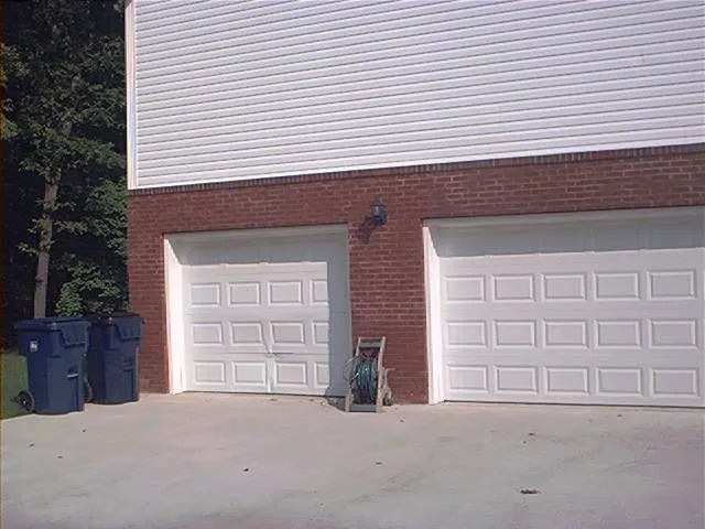

No doubt! I worked in the cold or heat/mosquitos for years, then when it came time to build a house I designed a 3-car garage and built a house around it. "Yeah, I guess we should have a bedroom or two and a bathroom, maybe a kitchen...whatever..."
Disregard the crunched single door. My psycho ex did that thinking she would crunch my 10th Anniversary Trans Am that lies just beyond it. Gotta love women.
Sorry for the threadjack. Great job on the enclosure. I agree with doing it in vinyl. I bought an extra stock enclosure just so I could play with enlarging it for better sound. Any chance you'll make another of these for a fee? It would be much easier the second time around.
