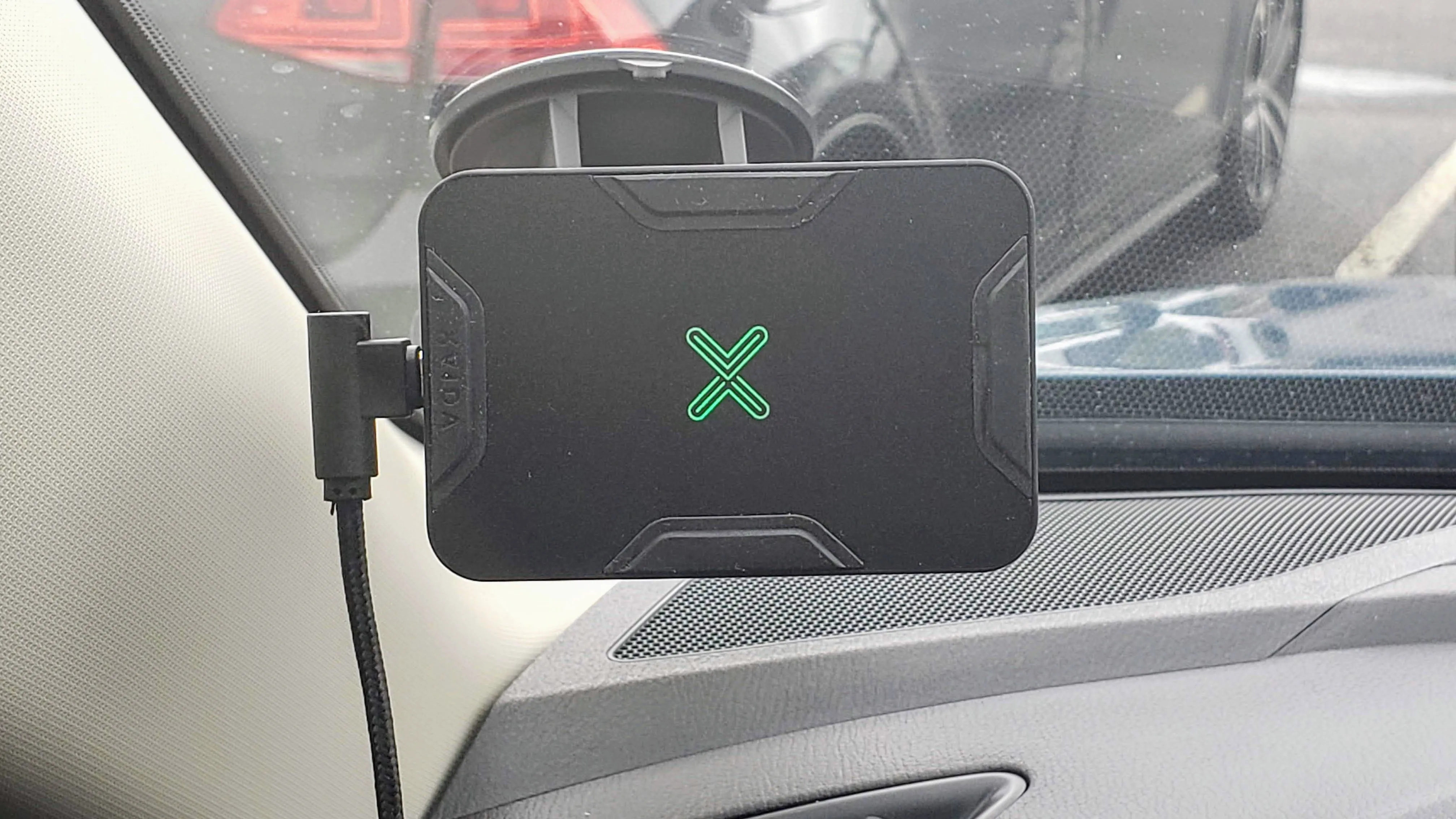

dudemazda: As for how I dock my phone I had been using a mechanical dock with a USB cable to charge. But I recently switched to a wireless magnetic charger. I bought the phone case (has magnetic built into it) from the same company as well as they are designed to work together. I have a Note 9 and the phone has not come off yet. I put it in the lower left corner of the windshield and use a 2.4A charging cable. The ends have right angles. See below.
When the phone (in the case) gets close it sticks right to this dock. When you're ready to get out of the car it just takes a tug for it to release. I use a high speed charger that plugs into my center console so I picked up a 10' charging cable.
This is really cool. Which company is this? I might as well just buy something similar.
