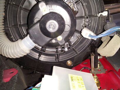

Check to see if you have voltage going into the blower motor itself. (it may be less than 12 V at different fan speeds)
If there is voltage right at the motor and it's not turning then the motor is bad.

Check for voltage right at the blower motor connector itself without unplugging it. Poke your multi-meter probes right into the connector.
It's possible that the felt that holds the oil in the motor is all dried up and the shaft is all sticky. Then over time with it turned on, it heats up a bit just enough to release and start spinning again,... till the next time.
It all boils down to whether the voltage is making it all the way to the motor.
